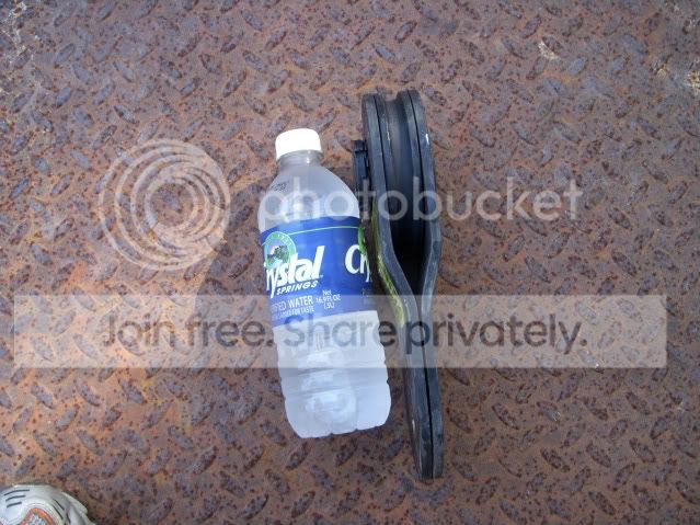

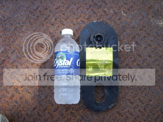

For reference: Mile Marker 26k military issue. Good for up to 3/8 line. Comes with with the new 12k up-armor HMMV's that have the hydraulic winches.
