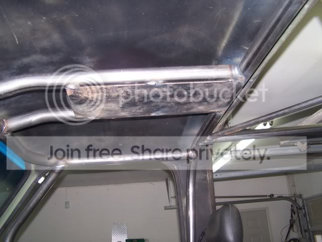

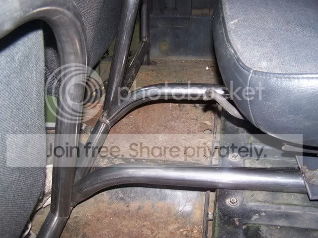

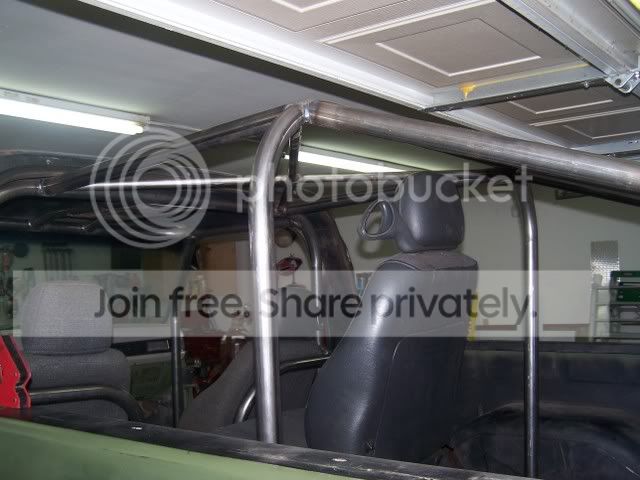

We used .175 .120 wall HREW on mine and I'm still using the hard top.

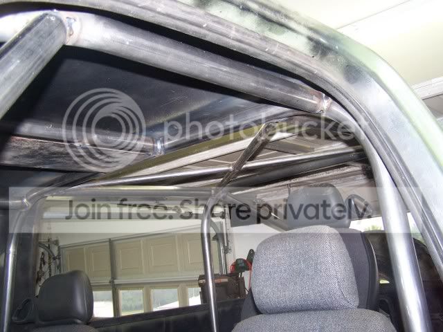

Not butt hurt in the slightest,and I know/knew the literal meaning supersaturated but just not how it applied here.I might have put more in the back than what was needed but I have an 8yo that will be riding back there.If I get out and get myself hurt that's my ass,but getting him hurt is something else.As far as the overhead in the cab I plan to mount a Cb overhead.I still have to get the seats mounted,5 points and my sliders.Im sure it's not as high tech as some but for $800 I think he's doing a good job.
