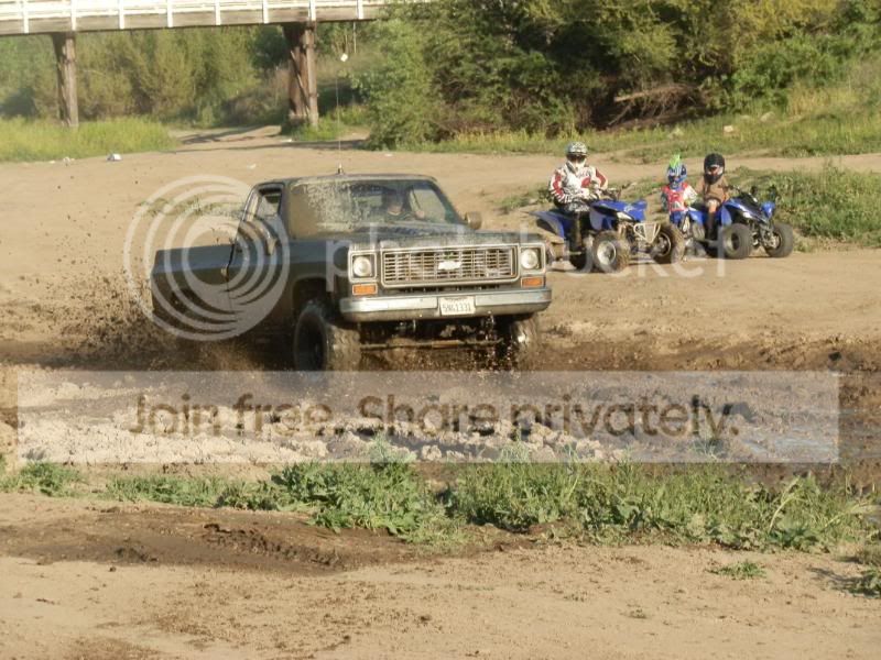

Have a 1974 Chevy shortbed with a 454 with comp cams K11-242-3(http://www.summitracing.com/parts/CCA-K11-242-3/), air gap intake, Holley 770 truck advenger carb, TH 350 tranny, 203 t-case, 3.73 gears in the axles and 36" tires. This truck is used for mud drags and need a better launch. It is great at the end of the run but lacks at the begining. What stall converter do you recondmend?

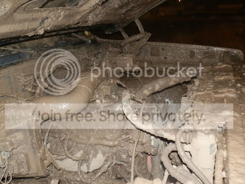

after the last race.
