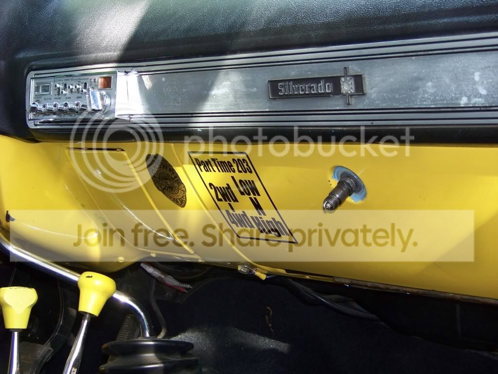

That's a sweet CB mount! I may have to copy that. The only vents I use are the defrost and floor vents. Awesome!:bow:
Oops, sorry for the hijack:doah:.
i particularly like that the cb is almost flush and looks almost stock.i also like the spark plug glove box latch.:wink1:
