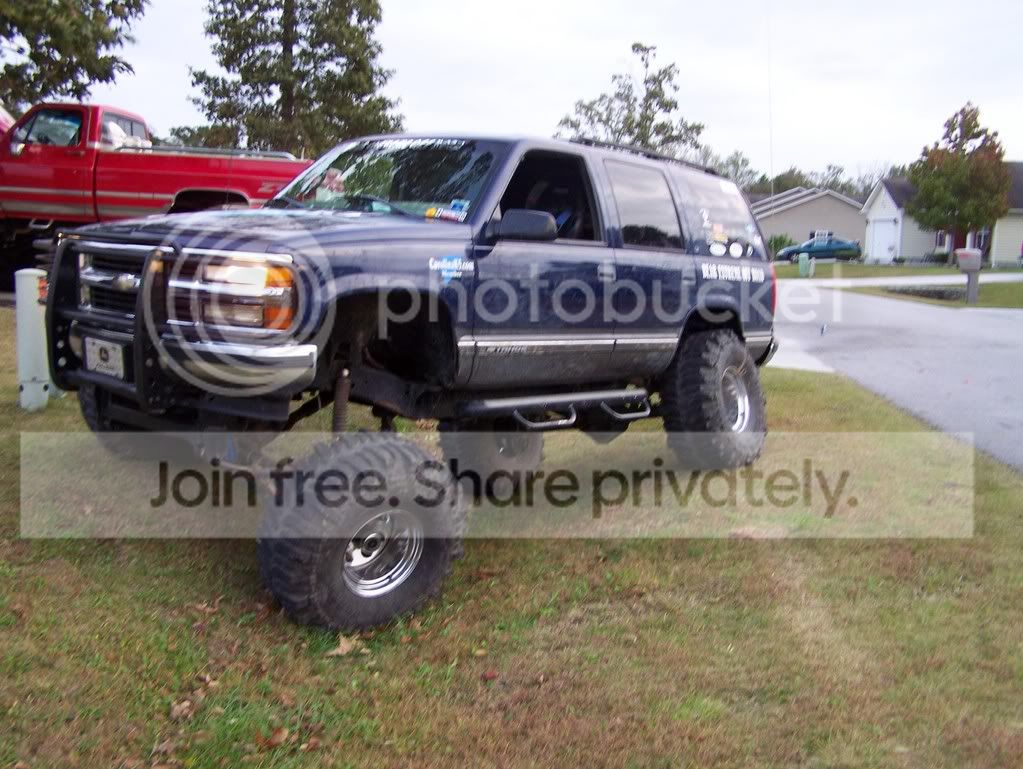

Do you have pics of your revolver set up in the front?
If they are indeed on the front I think you found your problem
Was looking at the hangers and shackles yesterday and I'm going to move them back and stand them up more but that's going to through the pinion down a good bit so I've got to get some shims. I was running 7* shims but when the studs stipped out at Gray Rock the Pass. side lower shattered. So got to get one anyway.
This is all that I have at the moment.. It'll be this weekend before I can get another...
sure looks like you have too much extension o the rear of the spring, and it's binding the joint. need to limit it, turn up the pinion or both. how does the pinion sit at ride height?
That shackle in the front is a no no, yes it may be a ramp champ but are you building a wheeler or a flex out toy? I would ditch them.
