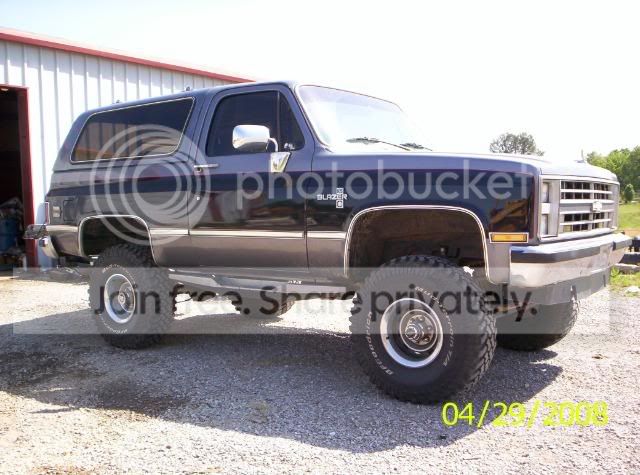

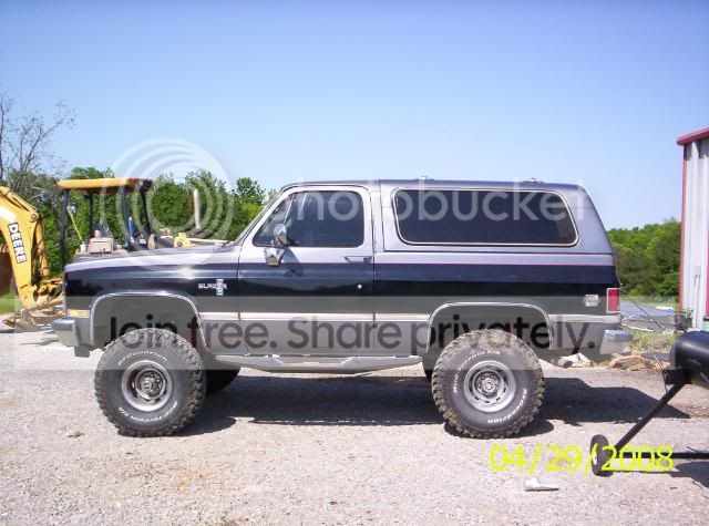

sweet 86 mine is an 86 too and i have 4" and i also ditched the old man boards.. i have 350/700r4/10b/4.56/35" setup i run about 2300rpms at 65
this was her when i got her
