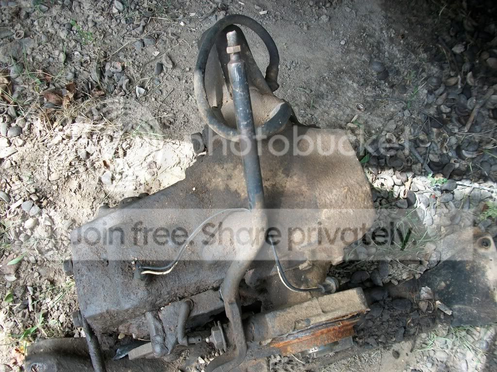

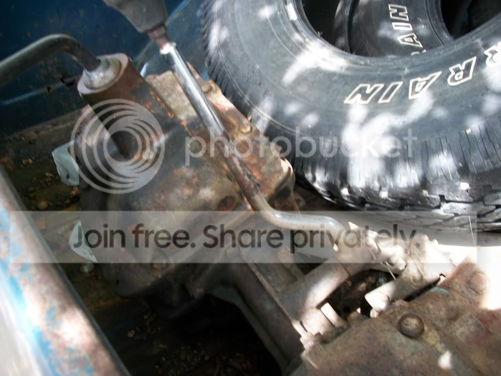

So I am planning to move ahead with the automatic swap. (leaning towards a th350 or 400... probably a 350- seems like the easiest one)
I have a 4 spd now but not sure of the t-case I have and don't know how to tell.
So please check out the pics and let me know what you think. (any info is good info- anything that I should know before buying a trans?)
I have lots of pics and get more if needed.
Thanks in advance for the help!

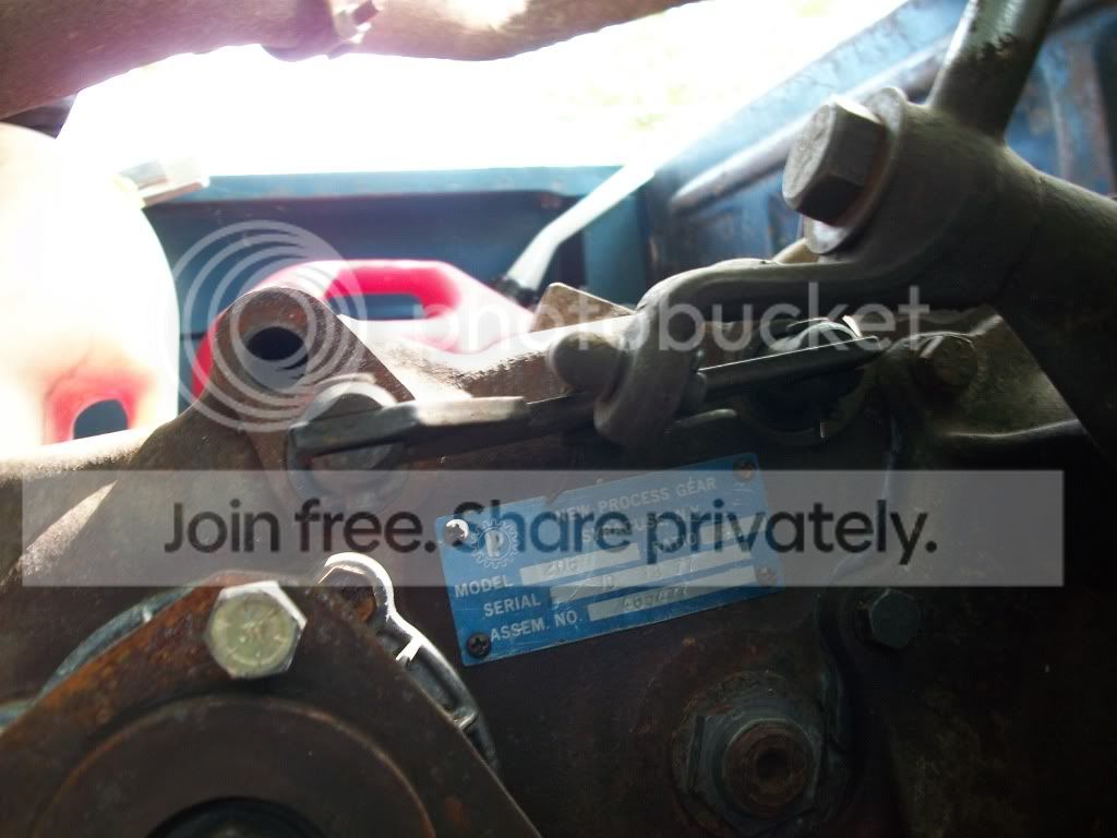

Lookon the front of the transfer case right under the shift rails and there should be a tag like this one. Of course idk if the 203's had them or not :confused:

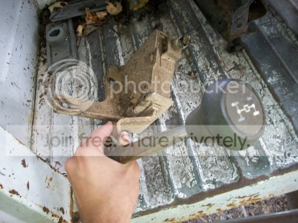

You can also tell by the shifter handle. If it's a round chrome or round black handle it's a 205 like these
but if it has a flat chrome handle like this then it's a 203
Atleast that's how i always tell
Thanks for the info Randy. I have the round chrome shifter.
I crawled under and scrapped off the grime and found that NP tag. I NEVER would have found it without knowing where to look... thanks again!
It says I have a 205, so that is cool.
