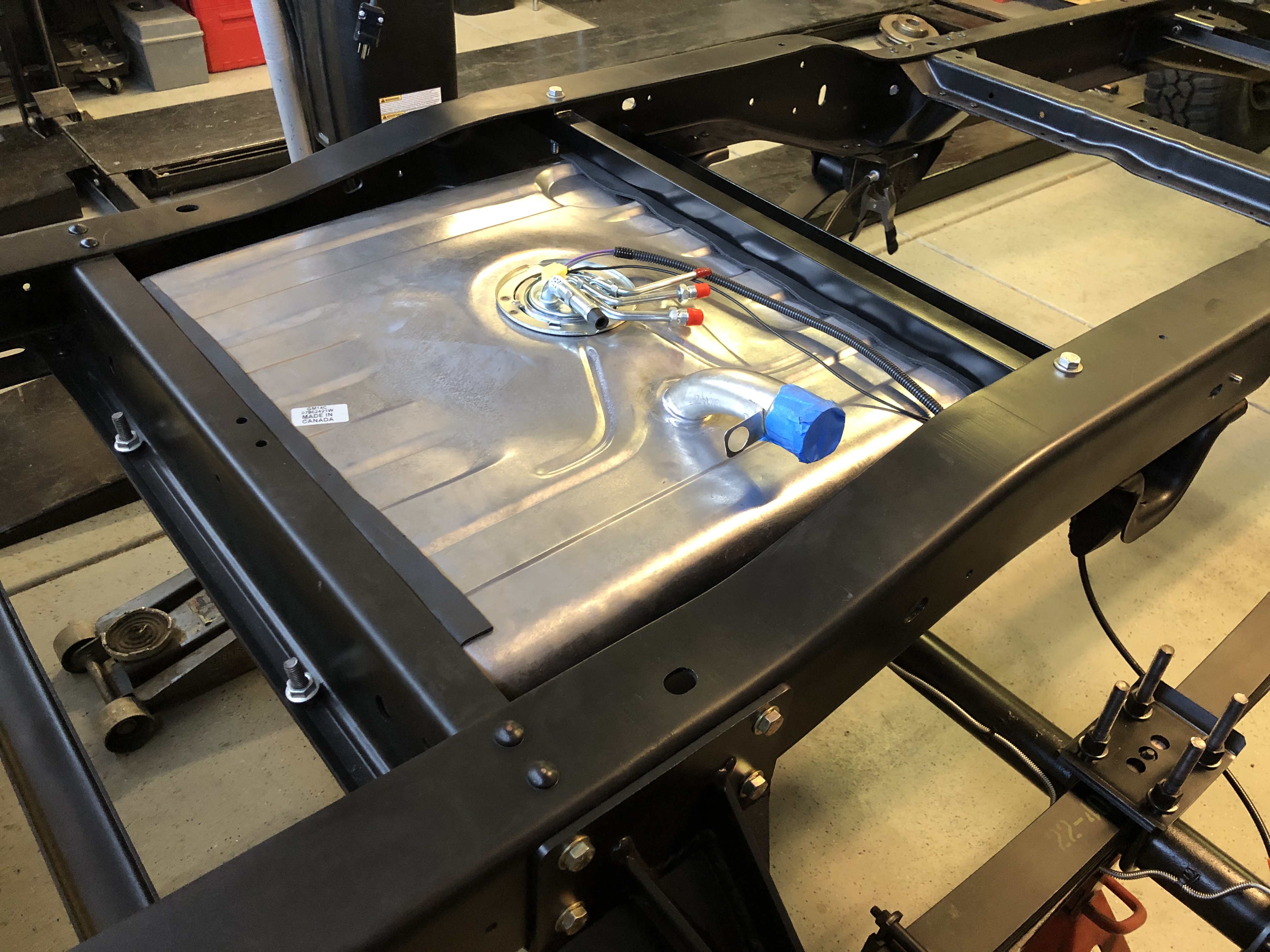

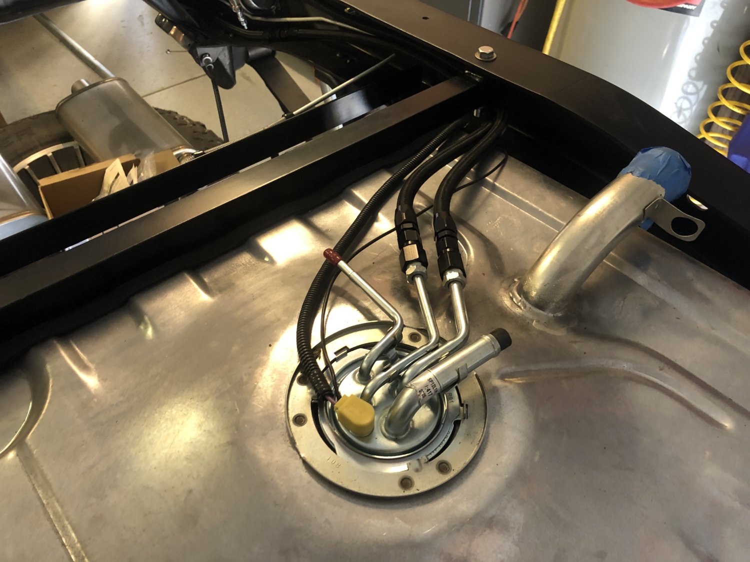

Single 31 gallon tank, needs its specific sender for EFI and depth
made the change 4 years ago. Should have done it sooner

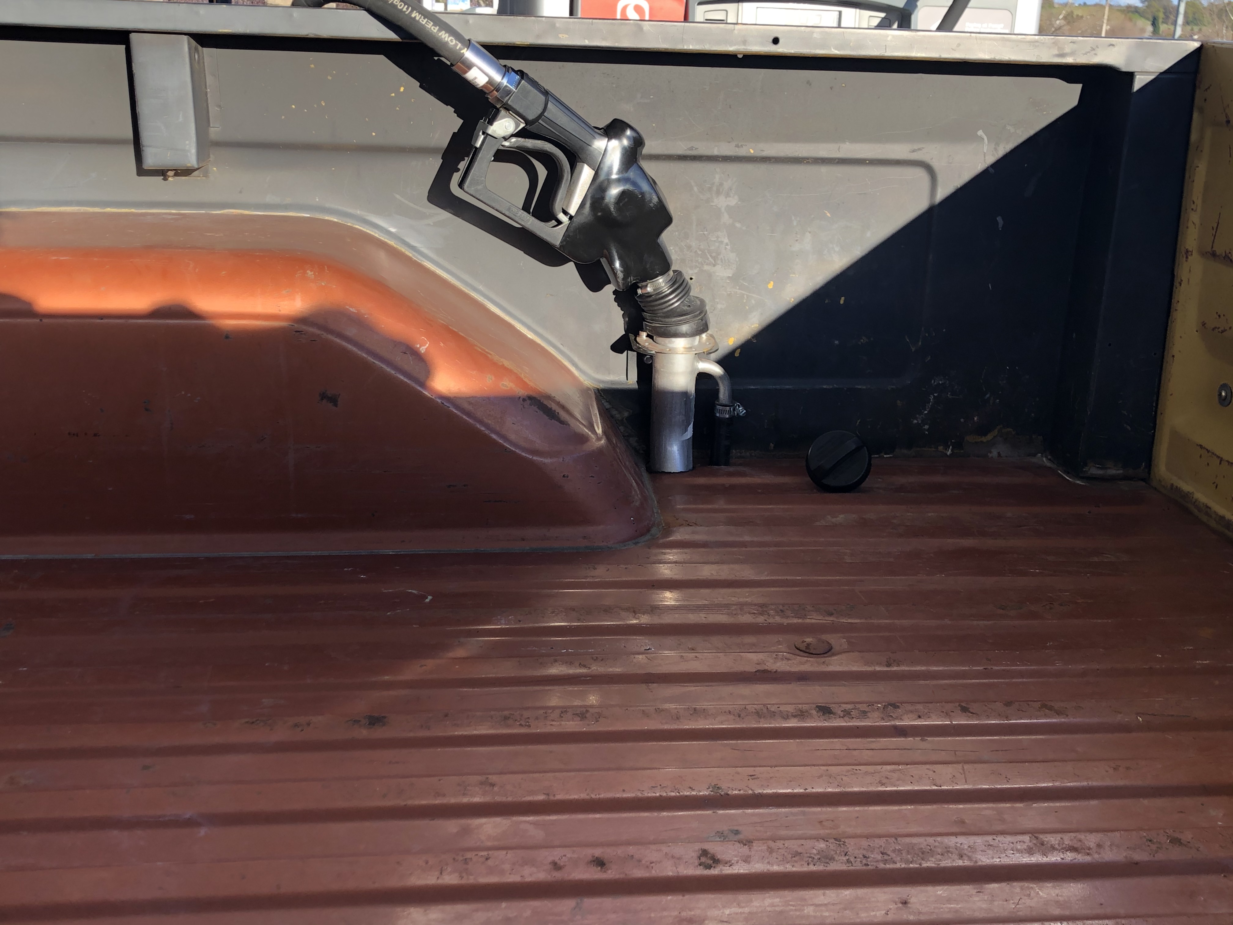

the only real thing to sort is the filler neck
I ran the hose to the bedside and relocated the filler there. Works great

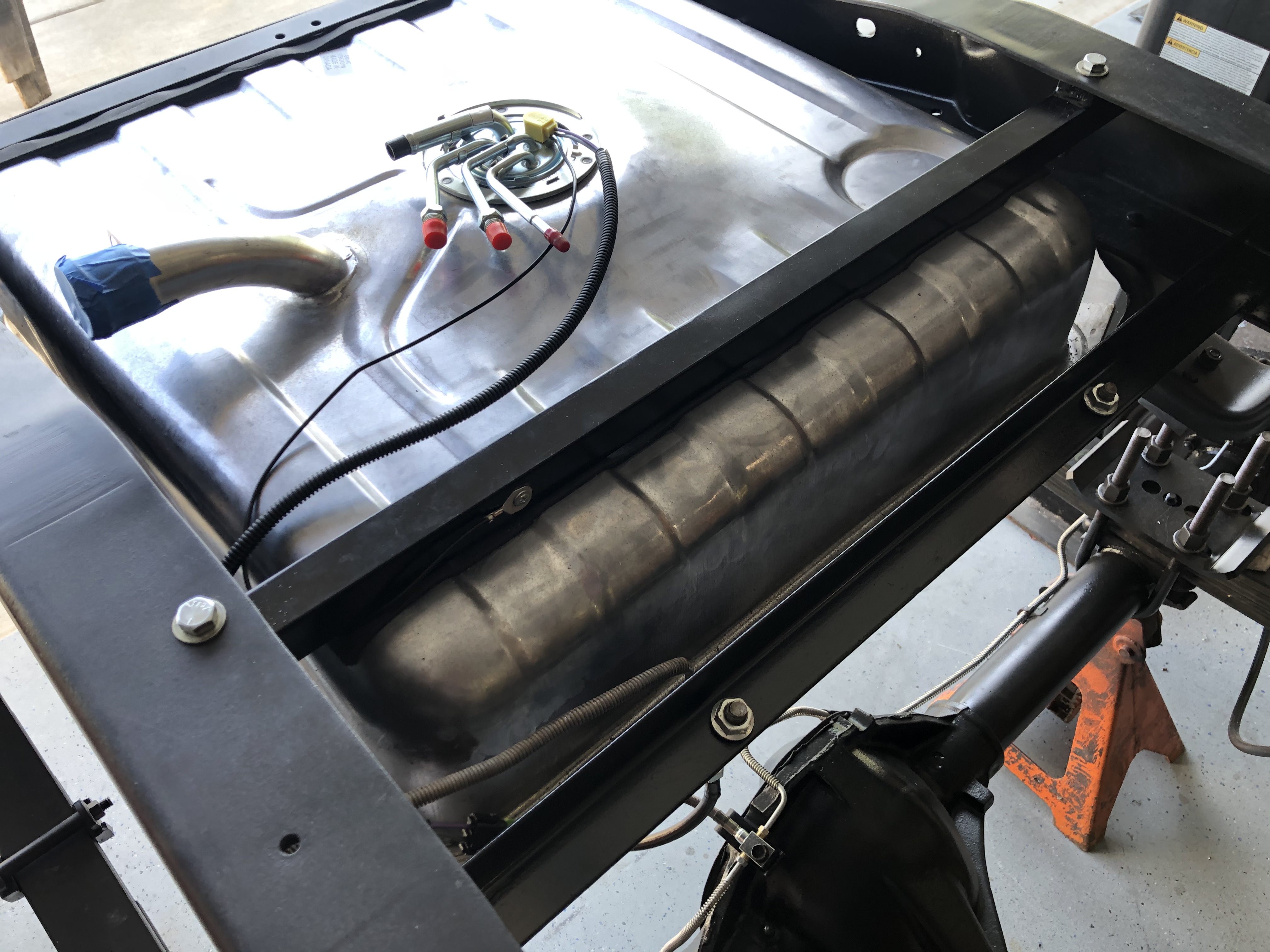

the 31 gallon tank is a pretty straight forward install on the long bed.
I added a forward crossmember (1.25" sqaure tube IIRC) along with some anti squeak single sided HVAC tape you can find at Lowes. For the fuel tank straps I added a piece of angle iron on the forward side and drilled holes in the stock crossmember in the rear.

and the filler neck I use is 1.75" https://www.millsupply.com/unleaded-gas-filler-neck-81983.php?p=324357
It flows very well, so well I can walk away from it.
