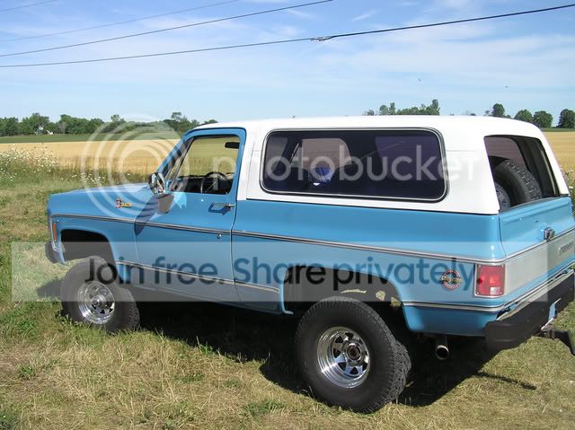

how it is now

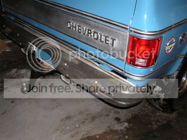

And the reason for wantin to do this is the rear bumper is pretty bad.
how do you paint over chrome. Would it work if i took my Dual action sander with 80 grit, would that be enough for the paint to stick?

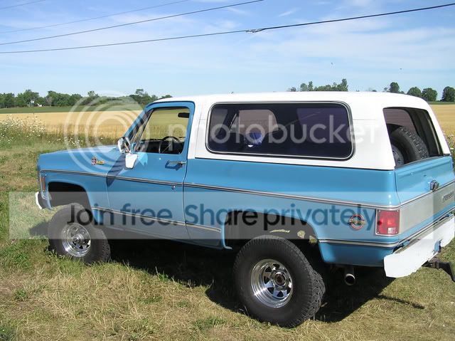

I'm wanting to paint my bumpers as well. I was told that even self-etching primer won't grab onto chrome very well. You may need to sand it down, or have it media blasted.
Yep, 80 grit on DA, then prime and paint. Not sure the black would look good on yours though.
white looks pretty crappy and cheap.
I dont know i suppose anything would look better than rusty chrome. or my Mexi-Chrome touch up. lol
You could have them blasted, but I would just try some 320 or 400 just to scuff the crome up and use self etching primer and paint. I have never herd of self etching primer not sticking to crome, I may be wrong but its worth a try. I thing scuffing it is the key. Keep all the sanding in a grain direction too. Just my .02 cents.

I really dont care for white, It looks good on some truck but i dont think itll look good on mine
Well if it is only a year then scuffem and paint them argent. Chrome paint sux it turns crappy. :D
