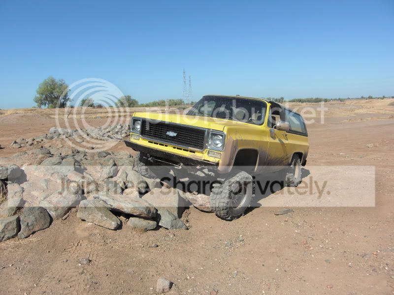

Hey guys,
New to K5s here, and I a currently trying to find my first one. I know what front end I want, but I don't know what years it was available. So what year Blazers should I be looking for? Also, if I end up getting a K5 of a different year, how hard would it be to swap this grille/front on? I know this is a basic question, and I apologize if there is an easy answer, but I have not had much luck searching. Anyways. here is the front end I am talking about:
Thanks in advance!
-Jason
73-79. 1973-1975 were full convertables, while on 76 and later they were the half cab design Id have to call it.
Fwiw, those headlamp bezels stopped in 78. 79 & 80 headlamp bezels are similar but wrap around the turn signals.
what grille is that? My 73 has the plastic one like this.
I think ive seen the straight bar grille one or 2 times on some trucks, but thats it. I really like the front of that blazer
I don't know, I just found the picture with a Google search. Looks like a standard billet horizontal bar grille.

I'm not afraid to make some changes, as a rust free K5 is most important, but I would love to find a rust free one with the '76-'78 front end.
Thanks again everyone, great info!
-Jason
I can't really tell from the pictures, but being a '79, and as best as I can see, it appears to have the chrome trim including the side markers, not exactly what I want. I appreciate the link, though! I'm going to look for a '76-'78 in good shape before I start going for other years.
