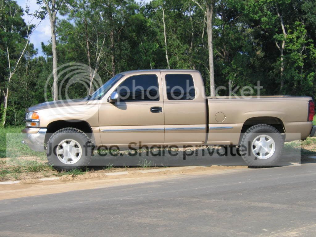

this is my 2000 with 305/70R16 on an 8" wheel. I also have the bars cranked up at least 2". stock wheels are too narrow for a 305. I put a 2500 bumper on so I didn't have to have the tow hooks hanging way out or have to cut my air dam around the frame. my tires are bald but you can see how close it comes to the front airdam and the inner liner in the back. they rub when they are new and I turn all the way to the left.

Cajun4x4 said:
i installed shocks for a guy on GMFS with stock 17s and 305/70s with ford keys and he only rubs at full lock when he hits a bump...
that looks really good!!!

Both of those are good looking trucks! Thanks for the pics!
