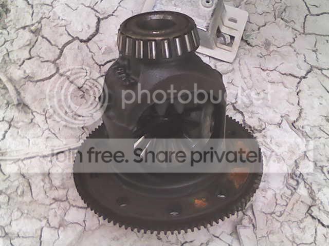

what's this for? *pic*
MattK
Jan 12, 2005
1,713
2
Dallas, TX
out at the yards this morning, found this carrier in an 80s suburban. what are the teeth for?
it was IN an 80s suburban? What axle? That is a tone ring for a wheel speed sensor. You will commonly see the setups in Fords. They have a wheel speed sensor up on top of the differential (above the pinion area) and it picks up that rings revolutions. Its part of the ABS system. A factory 80s Burb wouldn't have come with that.
1990-91 Burbs (and K5's) had that absymal rear wheel ABS... maybe it was one of those, would look like an 80's truck to the unsuspecting :thinking:
-- A
yeah i suppose i should have clarified it was sitting on the front seat of the burb, it really coulda just been set there for whatever.
-- A
The ABS sensor on those is on the tailshatf of the t-case. I know I didn't have a speed sendor in my 90 burb rearend.
I believe that type of carrier is from the mid 90s Chevy Impalas with the 8.5 10bolt rear end. They definately had their ABS sensor on the carrier.
:doah:
The part about "I found it IN a Burb" made me assume it was actually ATTACHED to said Burb :haha:
