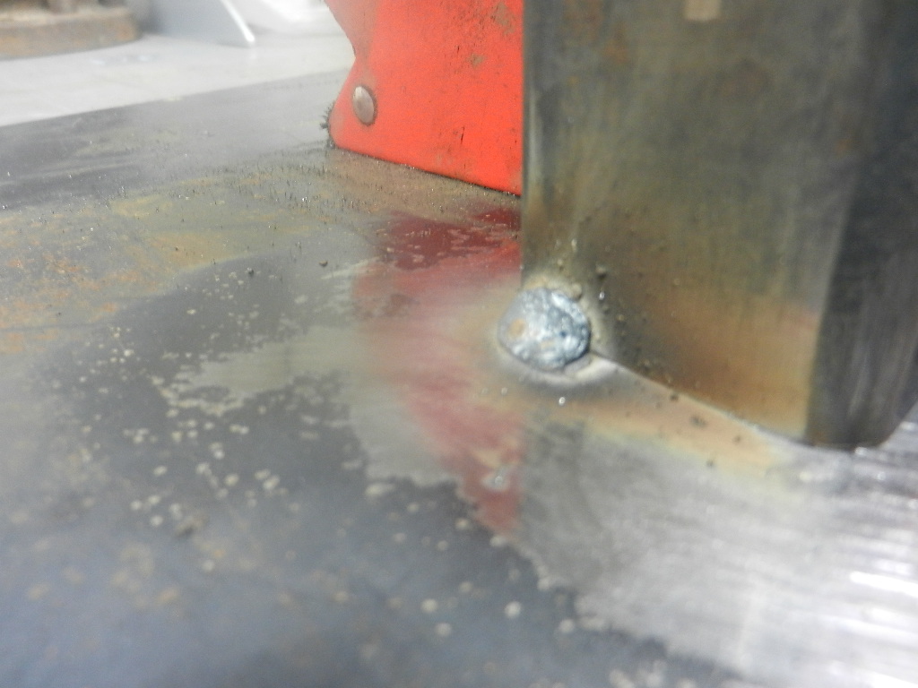

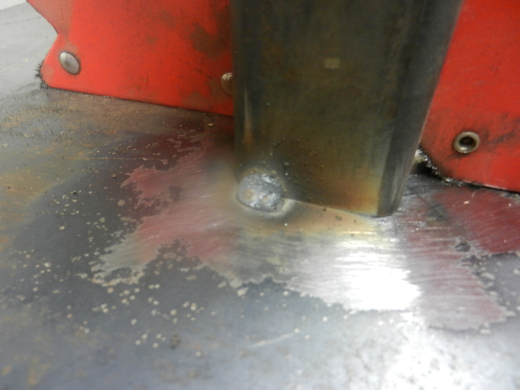

I've been laying down what I think are decent welds for a bit now, but suddenly I can't get any penetration.
as you can see, I am getting no penetration and the weld is coming out all pitted. what am I screwing up?
also, I just ran out of wire. related? :dunno:
Looks like out of gas. Sometimes I think those magnets cause some interference.
hmmm, yeah I am using gas. I could hear the gas coming out, but I didn't check the pressure. I'll look at that in the morning.
Not sure how about trying a longer bead. Doesn't look like enough heat and no gas.
If you are welding with gas did you change the polarity of the welder to weld with gas. That may be your problem.
No gas which may be from a bad/dirty nozzle also. Take the nozzle off and clean it out........
I have always used gas with this welder, so polarity isn't the issue. I did have a longer bead on there at first, but I was able to just knock it off with a hammer. I was attempting it again with the voltage turned all the way up when I ran out of wire, so I have just the short bead.
possible. I'll try cleaning the nozzle and see if that helps.
Could be something like a draft/breeze blowing it away. Or like was mentioned misadjusted, nossel with lotsa crap in it or your tip could have some spooge in it.
When you changed the wire you just take off the tip and stuff new wire through? Take anything apart were you might have hosed the orings?
Something is way more wrong than a nozzle or lack of gas. With the voltage all the way up you should be getting a little penetration sounds like your not getting any at all. That is why I though polarity.
It's definitely no gas...I don't care what you set the machine to, no gas gets you bubbles and a crap weld.
ASH what welder are you using? Is it a Lincoln. Sometimes just because I'm lazy I pull my welder around by the hose. I have on several occasions had to push it back into the welder. There are 2 holes that line up and o-rings that keep it in place that when tugged mis-align and no gas:dunno:
and we have a winner!!
Mine is an Eastwood 135, but yeah, that was the problem. Once I got the hose seated back in tight everything worked like it should. :thumb:
Thanks for all the help figuring this out guys. :bow:
