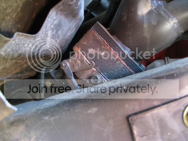

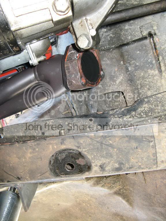

Taking my exhaust apart to remove the engine. Here's some pics of the riser. You can see where the riser hit the frame a couple times before I adjusted it further away. You can also see the remote mount oil filter system I had to do, so I could get to the filter after the Y pipe was installed.
heat riser, smog equipment
holds back exhaust pressure while warming up, vacuum operated
if all things are right in the world, it works :whistle:
K85, i must have my terminology screwed up. I was told the heat riser is the little thing that looks like dryer hose that runs from my manifold to the intake. basically dose nothing but give your intake hot air for warming up quicker i think. My truck has nothing like what you posted? But it was cool to see and learn thanks.
What K85 posted was a pick of the EFE valve. The heat riser is the small 1.5" diameter flex tube that goes from the exhaust manifold to the air cleaner housing just as you thought.
