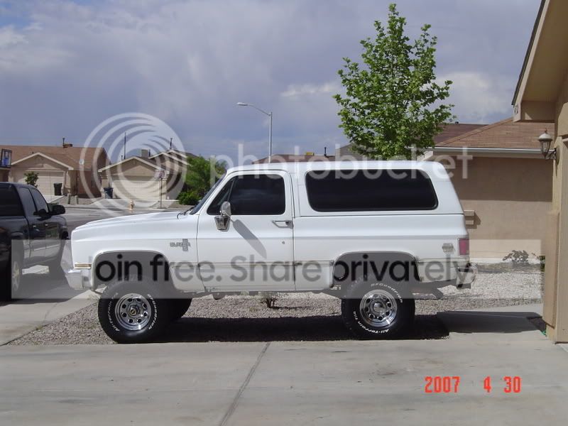

here's mine the day after I bought it 3 years ago. 4" lift with 33x12.50 dunlops on 15x10 Eagle Alloys. No idea on the backspacing. Mine rubs at the the rear corner of front fenders when I turn..
Looking at this pic, I really wish I left my Blazer alone.
here is a pic of my blazer with 4" and 33's
