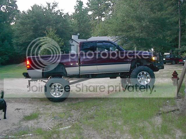

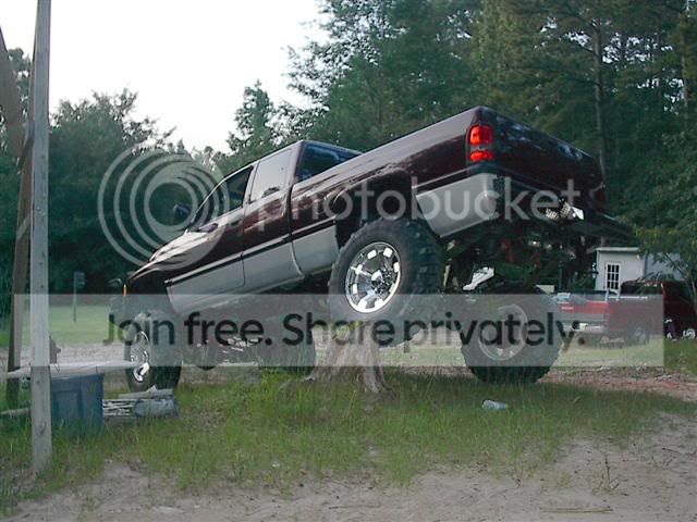

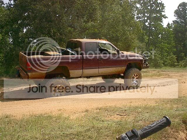

Here are some pics of my truck. I ran the 40" michelins on 20" aluminum wheels. I never had any problems with them. I aired them down to 15PSI when offroading too. I hit up a rock garden, did some good hill climbs, and even played in the mud with them and it was fine.
