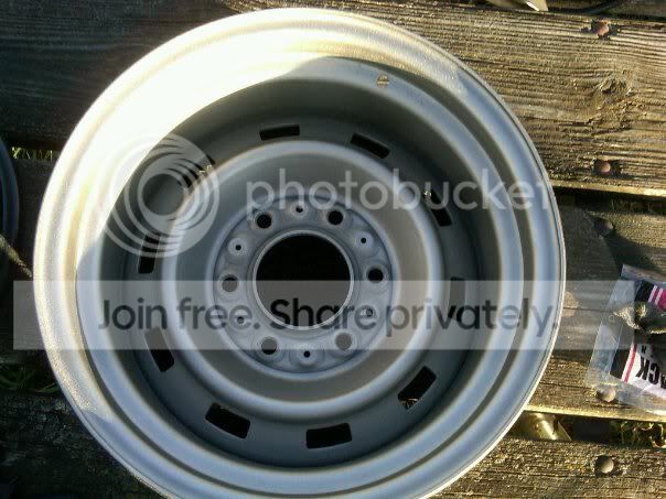

Worst looking rally

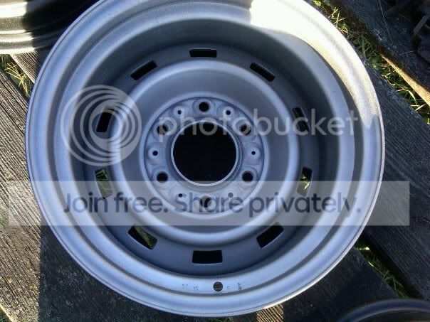

Best looking rally
Good enough for a driver. Out of 4 cans of fresh paint, 3 got clogged within first thirty seconds, and they all had red tips, and the one good can had a blue tip. All of the cans dad had used red tips as well, so im thinking it was just as old of paint, got them returned no problem. but wheels look great for a driver. Ended up using a tack cloth to clean the wheels of the old stuff after some 400 grit paper. Didn't use any wax and grease remover because the guy advised me against it since the sanding paper trails would allow the residue to stay in there, but rinsed it off with water let it dry then sprayed it. Good enough for a driver.
I had the same issue I think it is just the spray bouncing off the opposite face. Get the wall wet and smooth and the angle is dryish/chalkish I must of put 6 or 7 coats trying to cure that. I finally did a clear over it all and it went away.
