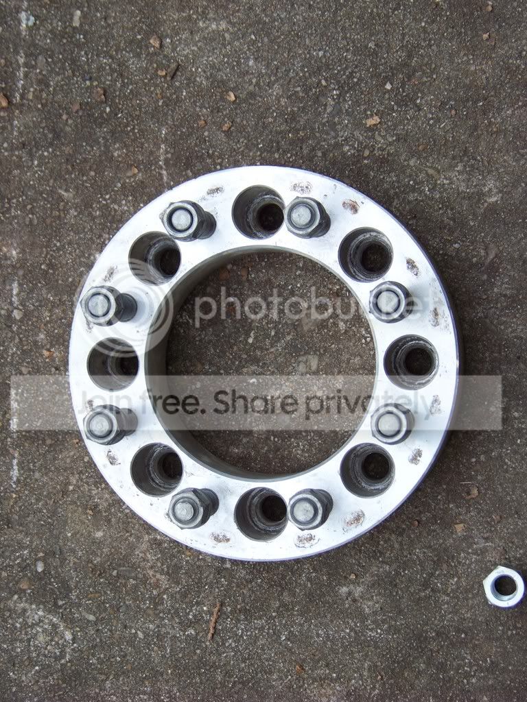

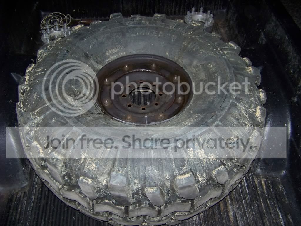

i went to put my h1s on the back of my truck today and the spacers i bought (used) came with lug luts on all the studs....now my question is the lug nuts on the spacers are super small and look like they would be for bolting the spacer to the hub but the lug nuts that came with it dont work on my 14bolt studs nor do my lug nuts on the spacer studs :confused: any one elce had this problem??here is a pic with the spacers in the background

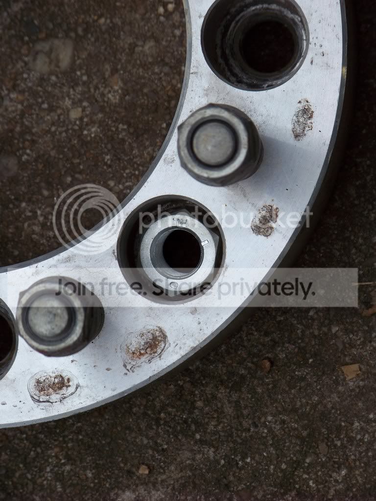

so i got a 7/8 nut and it fit inside of the spacer but NO socket that was 7/8 would fit in the holes....im really at a loss with this one here are some pics it might help...how can something so simple be such a pita :confused:
im also wondering if i have to run a "acorn" style lug nut with the spacers becuase if i dont then i might be able to make something work
You'll have to run a tapered seat nut, the bottom of the hole in the spacer is tapered. A regular nut would have problems backing off.
I'll take some pics of mine today, I'll also measure the dia of the hole on my spacers. Depending on how much you have in them (vs what you're will to spend), maybe you could have the holes bored open just a little to allow a socket. I dont think I've ever seen a 9/16" nut with a hex smaller than 7/8".
Mine are 13/16 but I bought them on egay in a batch of 100.:o
Dik
I've put a few of those on Jay. You're right not all sockets will fit them but I always seem to find a thin wall that works. Its tight but works.
