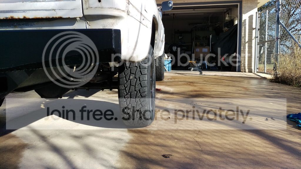

I use spacers from wheeladapter.com. I am running 2.5 in the front with 3" in the rear. It makes the edge of my tire flush with my bushwacker flares. Looks killer. Gives it a nice wide stance as well.
Word of caution though; some states do not allow spacers for inspection so you may have to remove them when you do it, and use RED locktite and torque them down to 125lbs.

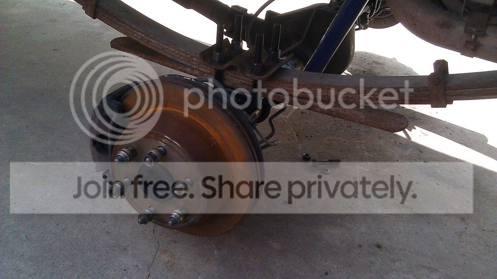

I just swapped in a newer 2004 Silverado axle, gets me wider stance and disk brakes.
