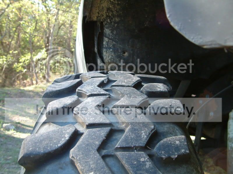

What i did was cut the fenders, unbolted the rear part of the inner wheel well, cut about 8" off the bottom of it, then took a sledge and hammered it back against my firewall/floorboard so my tires would stop hitting it. Works just fine and keeps all the stuff off my engine.
in this pic you can see where i cut and pushed it back-
