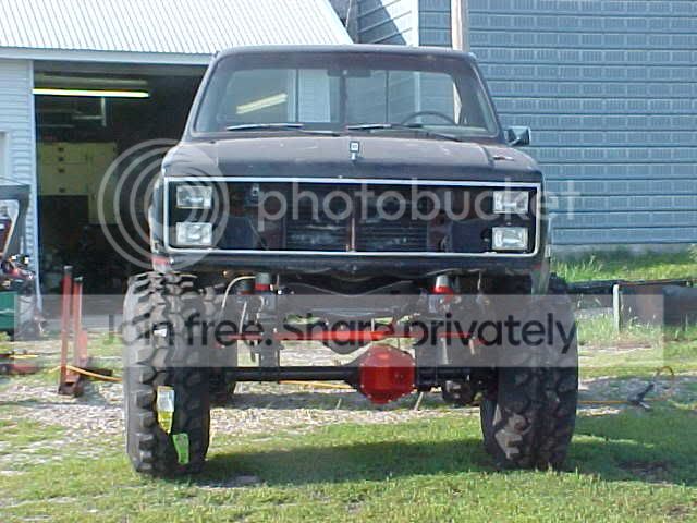

the pics i promised
right front
right rear
side
front stickout ;D
tryed to get a few diffrent shots but they dident really come out as i wanted...hope these help
