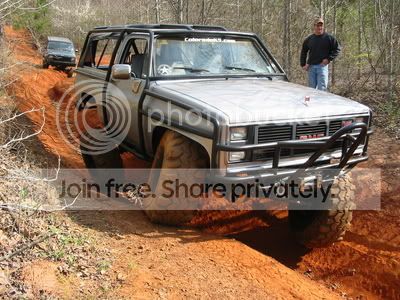

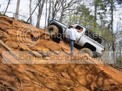

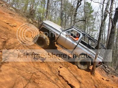

Got to do a little more wheeling this weekend with the new rig. I definitely like the exocage. It saved me from body damage more than once this weekend. Sorry this is not tech. bboy
sweeet, couple of questions for you, are those bias tsl or tsl/sx? and tell me more about excocage lol like how much? did u make it? sweet rig

the 42"s are bias ply
i don't have beadlocks, kinda looks like it in the pics due to rubbing

I am currently running 52" springs up front with the axle moved forward another 1" with zero rates. The rear springs are 56" backwards with overloads in place and a secured block moving it back another 3/4". Currently running 10" shocks in front and 9012s in the back. I have 9012s for the front but i have yet to modify the front shock mounts and I need longer brake lines. The wheelbase is close to 116". If you need more information let me know. bboy
bboy, the exo is very impressive! So far, have you found that it gets in the way or helps? I've heard some people say an exo can make an already wide body too wide. Personally, I love it so I'm curious.

I have no regrets with the exo. The day may come that I hang up on it but with it so close to the body I don't think it will be often. It already saved my soft top from sure damage. on the lift, I'm not sure. Its 55" to the body line below the door handles.

The cage is 2" erw. .120 wall. Bent with a manual Pro Tools bender

I would do it again. The truck has gotten a few compiments. I think the fenders could be removed by removing the core support first.
