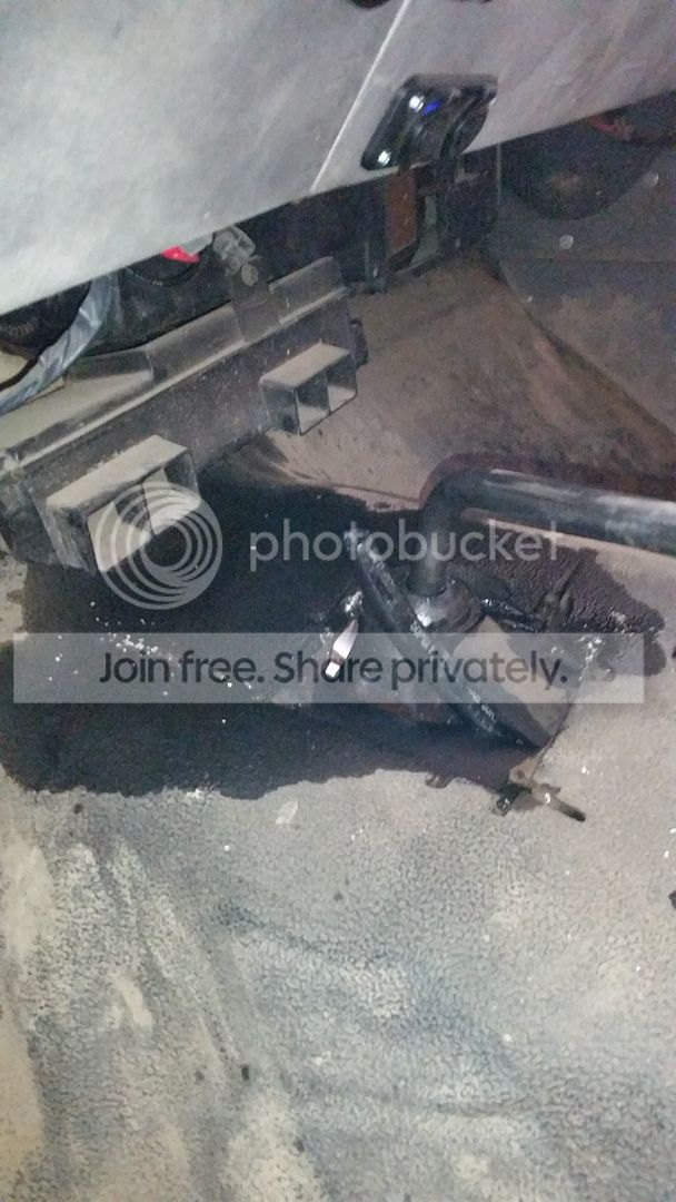

That said, on the way home (like I said, 130km...) got a bad driveline vibration any time I'm into the pedal, including coast. Goes away when I push in the clutch though. That, coupled with my SM puking gear oil out the tower onto the floor in the cab, and leaking bad between it an the tcase.

No clue on the drivline problem.
But on the transmission blowing oil out the top and the back....check your vent. If it gets clogged when the trans builds some heat it will push the oil out the easiest place it can find.
Can't the SM just vent from the tower, or is that more sealed than I think it is?
So I did forget, last summer did the adapter seals (and all the TC seals) because I was having the problem where the tranny oil was filling the TC. As a fix cleared the TC vent and actually ran a line up to the shift tower. Now that I look closer I'm thinking I'm having the same trouble, TC is filling from the tranny and puking out that vent. I'm not doing anything about it for now, if it blows up it blows up. Have the 6.5 and 4500 to go in once the weather turns, so the next time I pull it, it's going on the shelf!

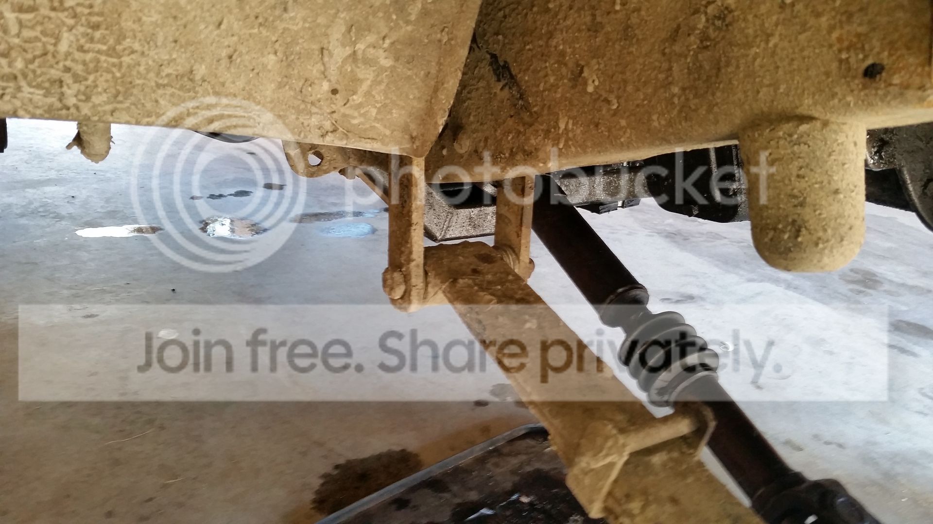

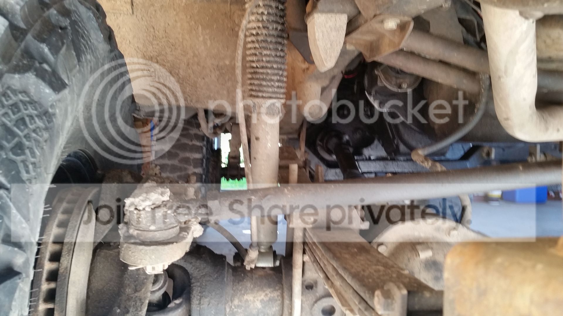

Tried to get a decent picture, but tough without jacking it up. The spring is about 3/4 outside the frame rail. I'll get this fixed tonight and replace the hardware, so maybe that'll fix my vibration. Is that spring being out enough to shake the truck?
