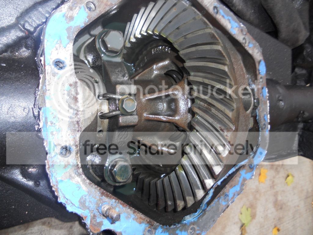

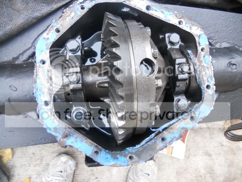

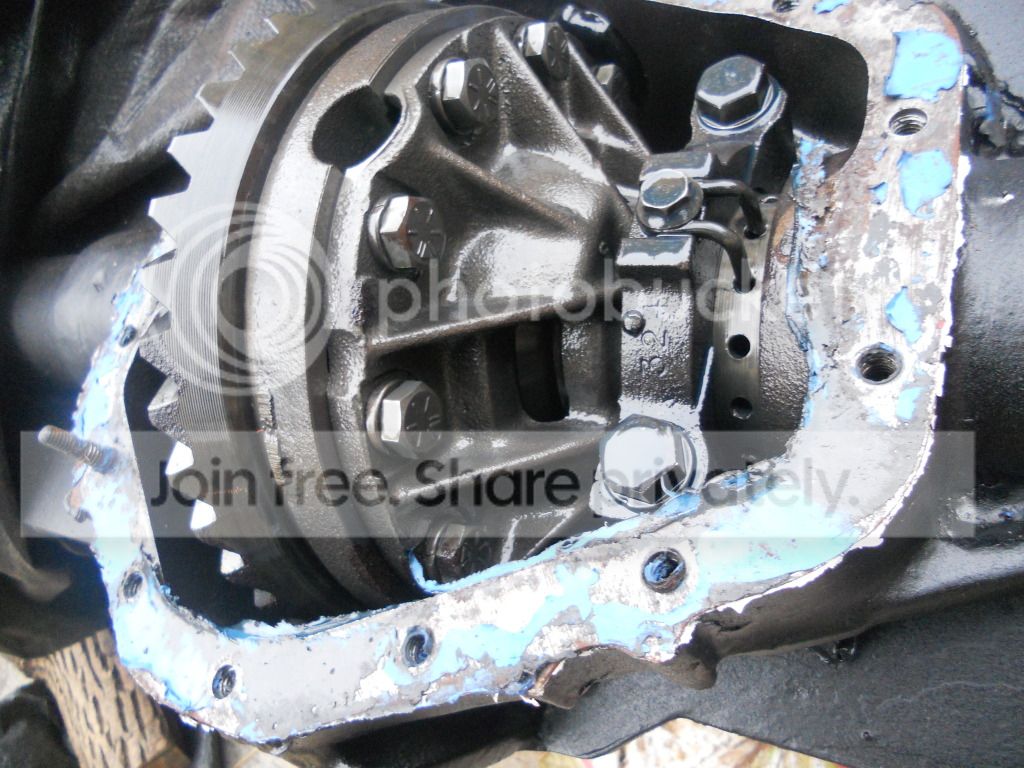

Here are picture of the rear dif (looks to be a locker):
From what i can tell, this is a locker unit, but not the Gov bomb. Correct me if i am wrong. I know the axle had some type of limited slip/locker in it, because with both wheels off the ground and if you turn one, the other turns the same direction. I did notice there was more backlash that normal, but as stated above this may be because of the locker (I have never worked with one before so IDK). The noise was right after i let off the gas, and in my opinion it is much louder than a locker should act, i thought the trans broke off the engine or something, it was LOUD. So i know this is not right.
What is my first plan of attack? Is there any way to tell if it is backlash or the locker unit? And if it is the locker unit, is the only fix to replace it?
