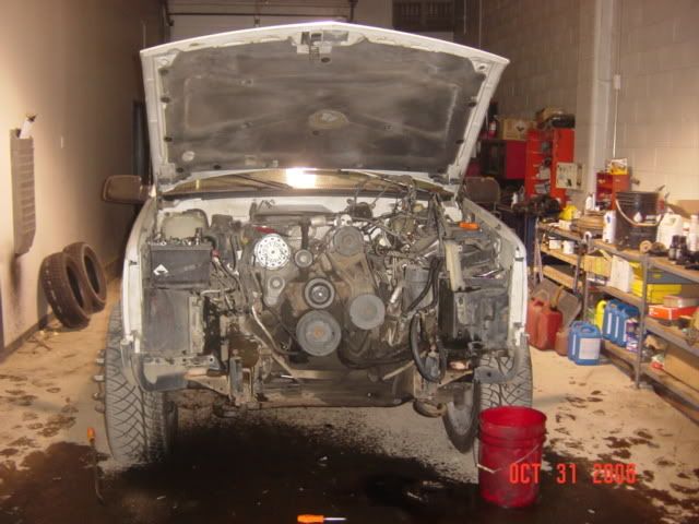

With my 3" body lift and 6" suspension lift, I used bare junkyard wheels so that I could roll it out from under the motor. I didn't have any trouble.
why not just pull the rad support? I think you said you had the rad out already? its not hard to pull. really it makes an engine swap easier in epic proportions. easier to get to at everything easier to swing in and out. I pull the 7.4 vortec out of my dually with the nv4500 its on it. just dropped the t case 1st.
