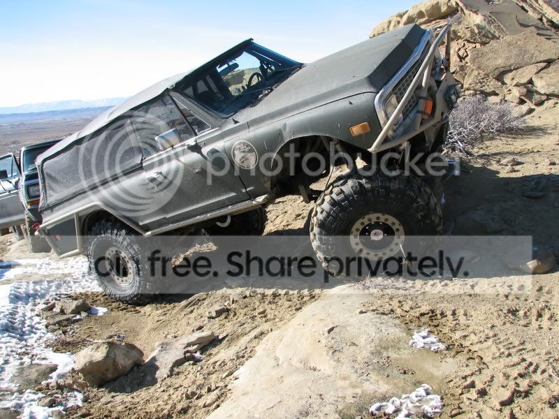

on mine i just rattle canned it with the exact name of the paint was something like rustoleum camoflauge olive drab the truck is this one
it was only like 5 bucks a can and i think e might have used like $50 worth plus easy to touch up
