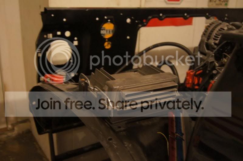

mine's gunna go on the left inner fender, or the inner left radiator core.
its not bolted in, but here's what i'm looking at.
That might interfere with your windshield washer reservoir. But that's easy enough to relocate as well. Thanks for all of your input. :waytogo:
Mine is on the drivers side inner fender. I'll just relocate the washer reservoir.
