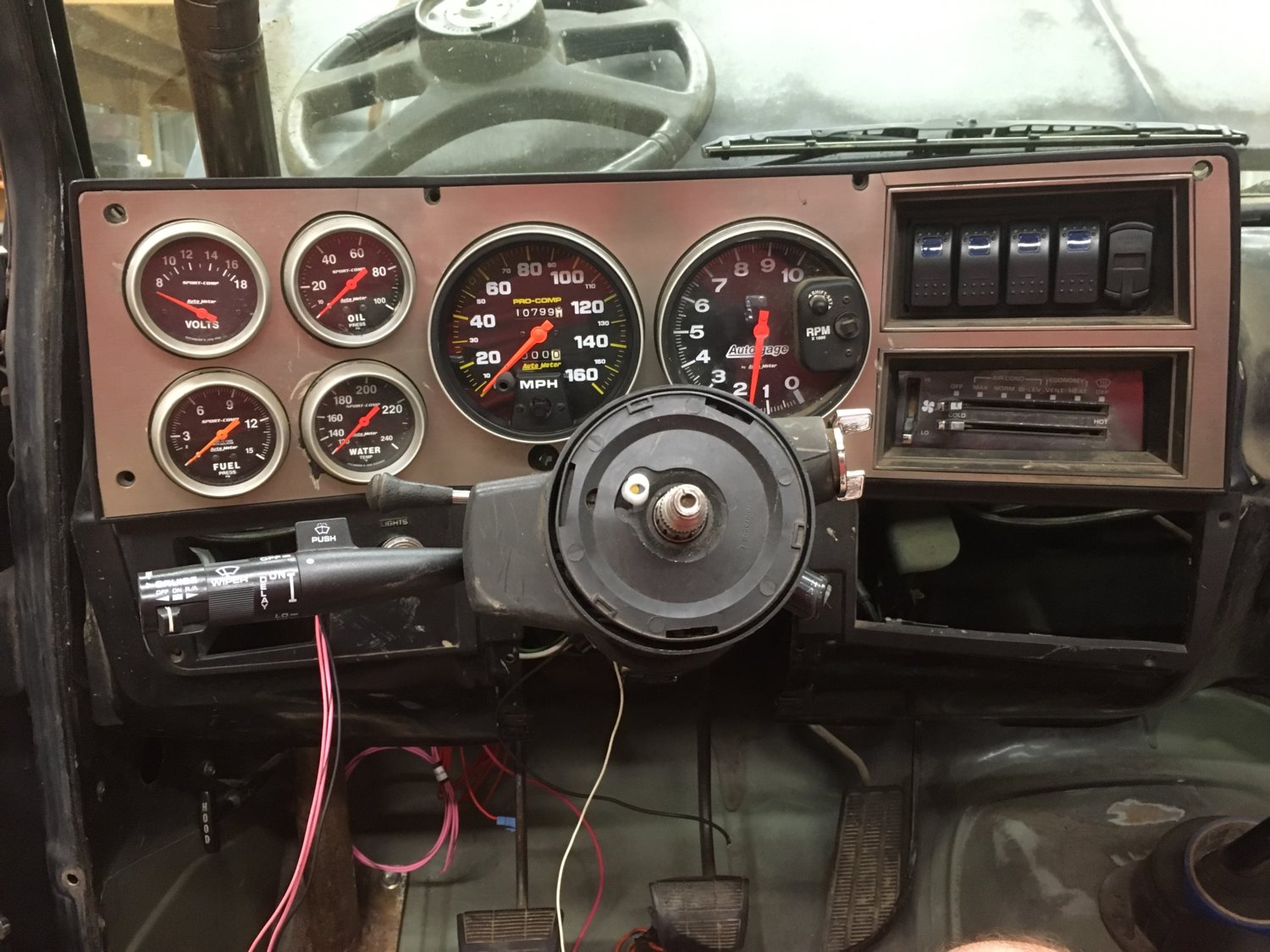

It’s no help but I put a switch panel in the upper a/c vent spot and fit like it’s factory.

This is what I did (Amazon switch panel).

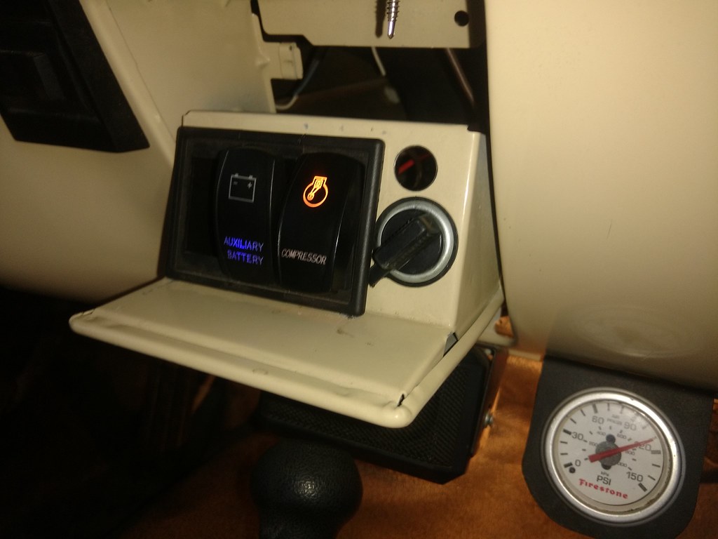

Here is what I made quickly when I needed it ready to go play. I made it bolt onto the bottom section of the dash so that I didn't put holes farther up. My theory is that the dash won't look as bad if I do move the panel somewhere later.
I don't care for the wire routing very much, or honestly the placement. However it is accessible from the seat or with the door open.

Thanks. This is a '90 with the adapter for the stereo. The adapter wastes some space, for sure.

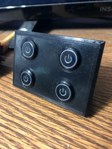

I've been thinking of carving a plastic box to fit between the ashtray and radio. Would mount a series of switches on top of each other, like portrait style. The wires could route through the hole for the rear window switch. Could also use a shaped mount there for an auxbeam type of panel. This would actually be a good 3-D printing project.
The cutout for a Carling switch is less than 1", so theoretically you could have a 1.5 DIN panel that holds switches sideways and a 1-DIN radio. I just checked Etsy and nobody seems to be selling them. It would also be great if somebody was printing a 1.5-1DIN adapter plate that angled the radio face upwards. Since my Kenwood offers bluetooth remote control, if I have the tablet in, I'll use that as the radio display. How are you supposed to search Gigs of folders on a tiny screen in front of your knee with little chicklet buttons? Probably safer to find it on Spotify on your phone while driving.
