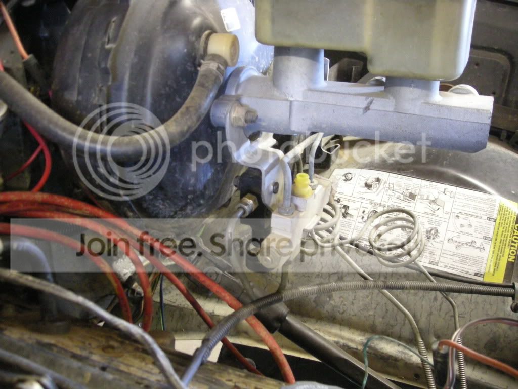

On my 1990 K5 I just bought, it's mounted under the master cylinder using the studs for the master cylinder. I'll look for a picture.

A pic would be nice if you got one.

Oops, wrong pic, try this one.
Martin
well that is a pic now isn't it, how bout one of the prop valve....:haha::haha:
Haha, yeah my internet connection is slow as can be tonight for some reason. How does the edit work out for you?
Martin
Pic looks much better now, but thats the fixed calibrated type Martin, I was looking for this type:
But I can just as well make a mounting bracket for it right off the hydroboost....thanks for the idea.
he posted a catalog pic of your adjustable valve, I don't think he saw it in the pic, it's kind of hiding behind the bracket
I can see the picture now. Yeah, there is an adjustable proportioning valve there. It is on the backside of the bracket, behind the factory one.
