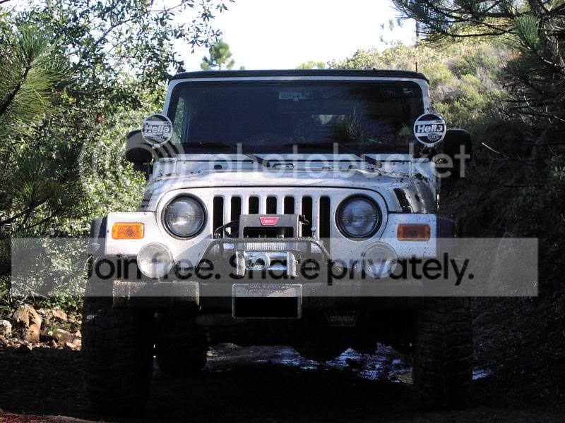

The Warn on my Jeep sat on top, not in front, I had no problems with approach angles(here's a pic)
I do understand what your saying though. Because on the K5 it would sit in front if I did the same thing.
