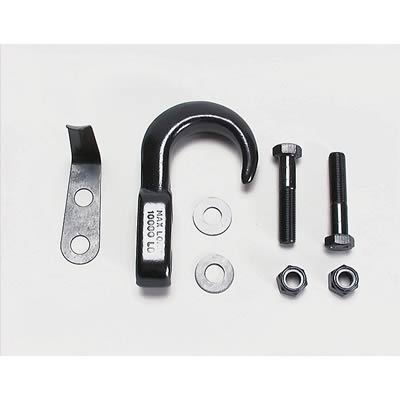

these are the hooks I bought.. thanks for the suggestions.

tow hooks, especially the ones you showed in the pic are not safe in this application.
most of those chinese cast hooks are good for 10,000 pounds. you may think that is a high enough rating, but you will find out that they arent, and hopefully you live to tell the story.

Those are mooring posts for a boat, not tow hooks for recovering a vehicle. Those are cast hooks that break before they bend. The holes are too close together as well. They don't give you a backing plate either.
