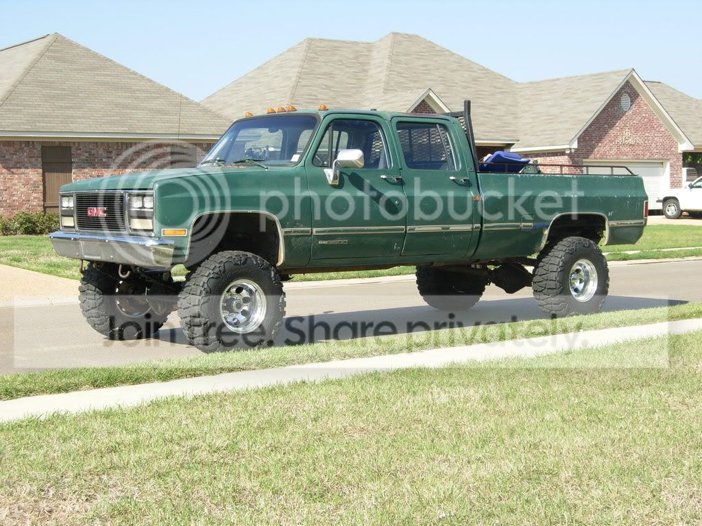

etc. Seriously, with the exception of the weird rear wheel setup (weld-on dually disc conversion with SRW hubs), the stuff is all bolt-on, lumber rack, tool boxes, etc. ;)
No single thread -- lots of people seem to prefer the per-topic thread. (Though I do have some stuff to add to my K5 thread...)
-- A
I remember reading about tubbing the wheel wells and the axle swap. What's the axle out of again?
Not swapped, it's original (I tell ya, that truck is mostly stock :haha: )
It would be a C&C 14b if I'd swapped hubs, but in the end I kept the SRW hubs, and just moved the brake flange back to wherever it needed to be for dually brakes with those hubs.
The disc stuff is TIGHT inside the dually wheels; I had to clearance the calipers with a flapdisc (mighta had to use a grinder a bit) and I'm not entirely happy with my choice of rotors, but she stops quickly and predictably, which is nice.
