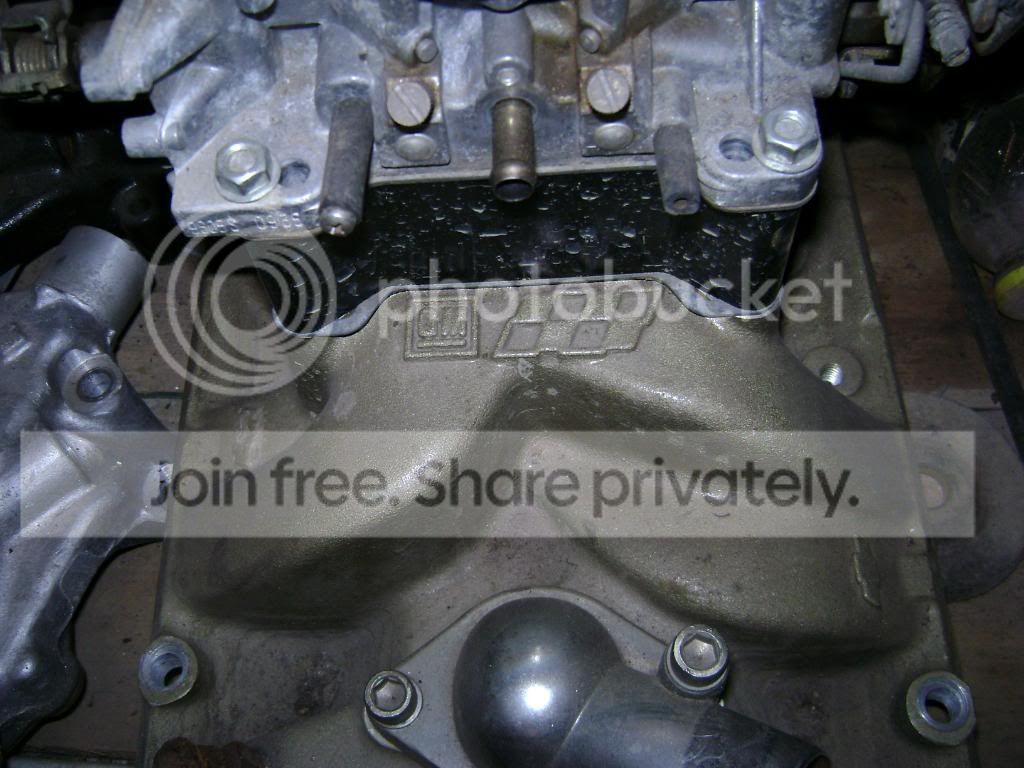

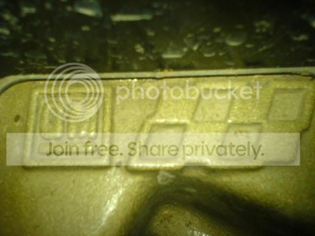

motor has low end and will scream...they have 2'' hollow stem int /1.55'' sodium filled exh valves and i have a gmpp intake, 2'' phenolic spacer, a carter afb, & the tall k&n tunnel filter...requires hole in hood
i have a pic of my induction..lets see:
