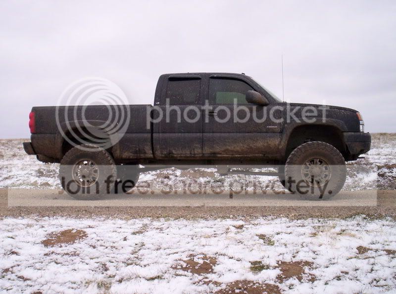

id go with a full drop kit, fulldrop knuckle lifts like cognito or tuffcountry are nice, dont know what the tuffcountry runs but the cognito is spendy, RCD puts out a decent kit but i couldnt see paying for a 6" lift that only drops the diff 4.5" which means your CV angles will be worse than a 6" full drop kit set at the same height.

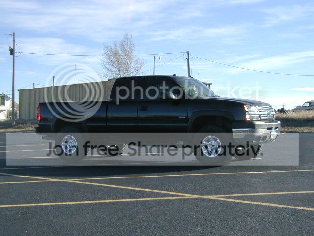

with these HDs you can fit 35s stock even on after market rims, with a 6" id go 37s
HD with a 6" tuff country and 37s
same truck stock with 35s

can you fit 35's stock..sure will it rub like when something as simple as a curb..yup, my hd rubbed once with the t-bars cranked a little and 285's..that mearly came to a 32 inch tire.
i cant see the 6 inch being horable on the cv angles, I was also taking into account the nice shocks the lift comes with when I speak of the value or quality of the lift kit.
there are several threads over on gmfullsize with dissatisfied W4M customers, ive talked to the man on the phone and he seemed like he new the basics and was confident with those questions, but once i started asking him if he could alter my tune to work with a 4l80e (which he has the software for) he straight told me he had no clue how. it also took a hand full of phone calls and over a month to get my tune in from the date i paid for it.
i wasnt saying the RCD is a bad lift, it isnt. ive jsut never been a fan of the non-full drop knuckle lift design. i do love 5100s, i bought some when i purchased this used trailmaster lift. and goin to be running 14"ers when i sas the guy with that duramax had a 98 z71 a while ago with a RCD lift and he seemed to absolutely love it from what he said, i dont know his exact reasons for not going back with another RCD, he had talked about doing it for a while
as far as the rubbing i have no first had experience, just what ive seen other ppl post pics of and what that guy told me he didnt rub after he cliped the corners of the valence off like in the second pic, many ppl also have different deffinitions of "fit", to me some minor plastic triming means they fit, but hey to each their own
