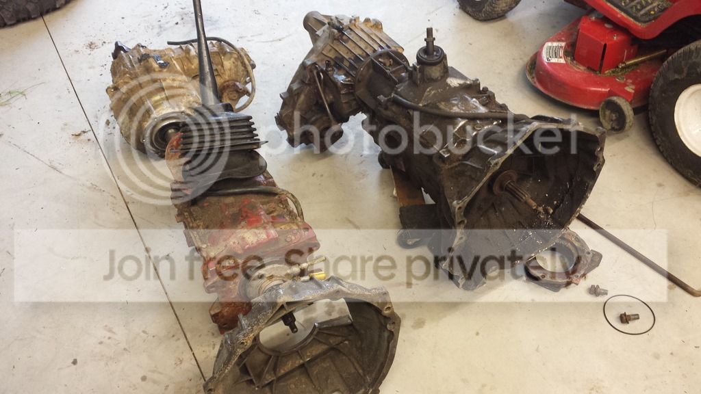

I've decided that I'm going to make the switch to a hydro clutch.
Now I need to make the decision on which Nv4500 I have to use. I have both the newer and older style. My guy feeling is to use the older style that has the external slave cylinder...just for ease of future replacment. I haven't driven either one, but I trust the source that the older one came from. When I picked up the newer one the guy said 3rd was starting to feel notchy when shifting....come to find out it had regular gear oil ran in it. So that one will probably need syncros at the very minimum.
Does the newer one offer any advantages over the earlier one that I should use it instead? I know the shift towers are different, not real sure if that make much of a differance in shifting. Other than the 1st gear differances and the slave cylinders, aren't they basicly the same?
Edit: Yes I know the t-case behind the newer one is drivers side drop.

I've got a new square body master cylinder to use and planned on buying a new slave for which ever one I decide on. Think I have part of the old line I can use to connect the two as well.
I have seen the short throw shifters for the 4bolt cover. Didn't know they swapped over though, may look into that.
Looks like the older unit is going in.
Does the transmission care which bell housing/clutch setup is in front of it? Can the older box run the internal slave? Vice versa? Or are the transmission cases different? :dunno:
Are you going to be rebuilding the transmission regardless, or just running the smoother one as is?
When they switched slave cylinder styles, the input bearing retainers changed sizes as well. The older one has a diameter of 5.125" newer one is 5.60" (same as Dodge).
You need to keep the bell with its respective transmission. I'm sure you could engineer your way around either slave cylinder, but with the avalibilty of the parts it's probably more trouble than it's worth.
An Sm465 bell can be used on an older style (93-94) Nv4500. You need to drill two holes in the face of the transmission and use nuts/bolts.
I'm going to run the older one as is. It came from a shop my friend works at. They wouldn't have saved it if it was bad. If it does end up giving me problems....then I might rebuild the other one and swap them out.
