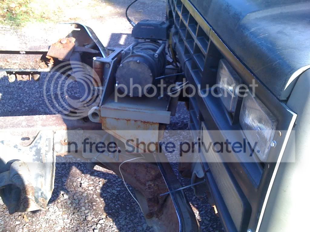

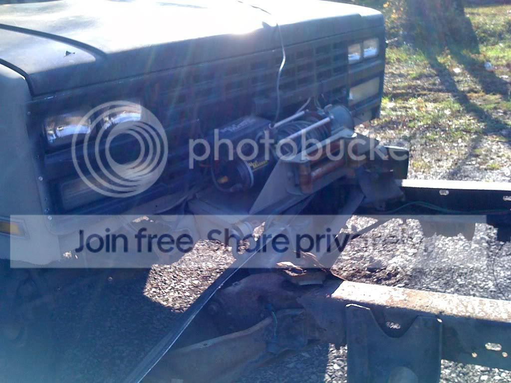

ok i have a 9000lbs mile marker on the front of the truck. ive used it for everything you can think of from pulling my truck out of the mud, to pulling an conex box off a trailer and putting it into palce.
one thing that i just recently learned the hard way is that you can have a 20k winch but if what its mounted to is only rates for 4k than guess what...
destruction and what not aside, id go for the biggest thing you can and make sure that its properly mounted
