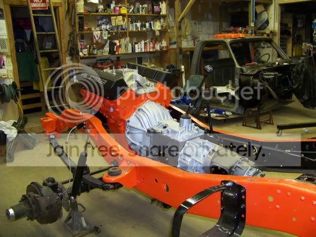

well im running a 496/4500/205 and my engine builder told me he suggested running a solid engine mount on the driverside to prevent destroying engine mounts... anyone do this? what are u running? im worried if i do run the solid its gonna tear the frame up.
heres a sneek peek at the project ive had for a few years now... one of these days ill put up a build thread

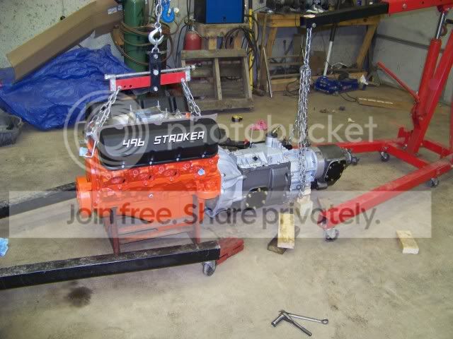

HOLY GOD!!!!! that is the sweetest thing i have seen. where did you get those valve covers and how do you get a 496 stroker?
lol. easy killer. its a 454 bored .60 over... 4.25 scat stroker crank, eagle stock length connecting rods with shorter JE srp pistons... and a few other doo dads inbetween ohh and the valve covers... ebay

BTW, Greg72 has a couple high HP/TQ engines i built for him. One is a 496 stroker and the other a 502. They will both make some VERY respectable numbers.

WOW!:bow: Nice! I think I am not alone in saying- we need more pics!
