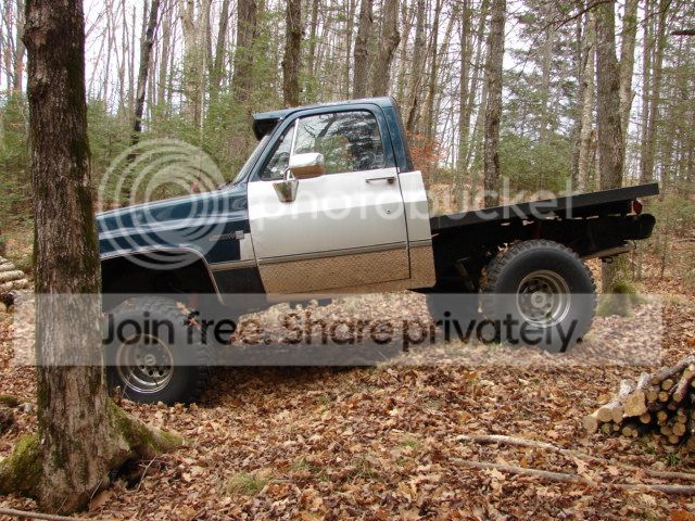

I have a used Lund unit w/lights that came on my donor truck. My M1009 body had an absolutely perfect roof and windshield area with NO holes whatsoever. There was no way I was going to drill one hole in my roof. The one I have is for sale if someone wants it. In a dryer climate I wouldn't think there would be as many issues of here in the NE for the risks of rust and rot through.
Here are my before and after pictures.
