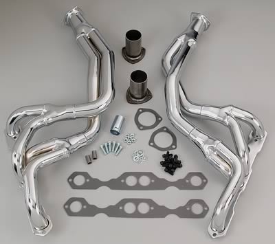

Ok I found that they can give you about a 12-17% increase. Plus the mileage gains too. But I now have a dillema about the Thorleys. There are 2 part #s that match my application: 300Y and 364Y The 300Y is both driver and passener are full length, while the 364Y has the driver full length but the passenger not quite full length. look at the pictures:
This one is the 364Y:
This one is the 300Y:

After reading about you guys having trouble with your shackle to header collector spacing, I think I will spring for the 364Y because the passenger side won't reach the shackle.
