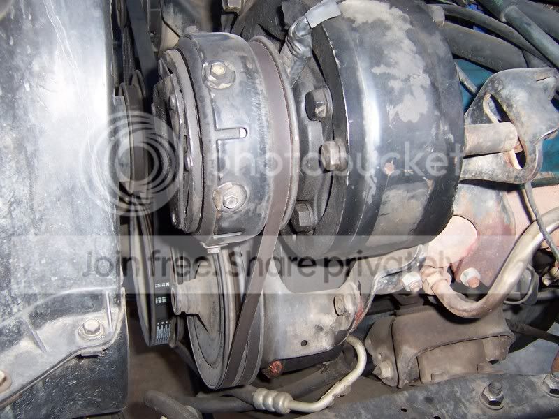

On a side note I want to yank off the compressor but it has a belt that goes around the outside pulley on the power steering pump... is it just using that as an idler or does the power steering pump need two belts on it?
So it's basically just using the outside pulley on the power steering pump as an idler to get the belt out of the way and back to the main pulley?
Yup
Yeppers as far as i recall
I think you could put a matching belt to the rear if you like but v belts robb lots of power

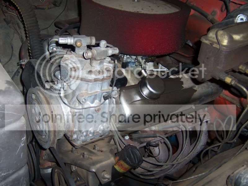

What's this?
I yanked it off of my dad's 390 the other day and haven't had time to do much research on it...

I should know that but it slipped my pea brain :doah:
yorks are the way to go, ive used them for years on lowrider air bag trucks, and i know they been used for manyyyy years on off road trucks as on demand air. that is definately the way to go. 100%. just my 3 cents worth for what it is.
matt
The other ac pump will work fine, just use an inline oiler on the inlet, then and extractor on the outlet. Lots of guys use them, and its nice that its already hooked up:wink1:
Then again you have a york, but brackets would have to be fabbed.
some brackets and be had at airbagit.com just check online they make alot of brackets for a lot of different vehicles. just my opinon, 79 fords had them full size wagoneers and cherokees had them also. or they are decently cheap at advance or auto zone.
matt
AVS is local for me and I bet if airbagit has brackets they would too but it's not a big deal to bend one up at the shop so if I decide to go the york route (and dad lets me have it :)) I'll make one.
Muddytazz also makes them, That's where I got mine.
Yeah, I made mine from looking at his pictures, not realizing I could just have bought a set :doah:But dammit, that's why I have a welder! :haha:
Yorks mount on a flat surface, either vertical or horizontal, so they're easy to do brackets for.
