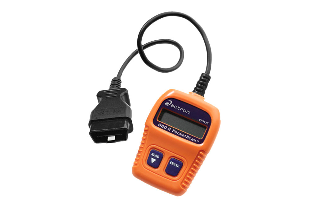

cheep code readers can show the code # only and how many codes are in it or pending to set a light . also it will show monitors run / incomplete . i have a cheep reader for 25.00 bucks that does just this and lets you clear codes also .

Okay. My reader is decent, cost me $100 or something. I'll poke around and see if I can find an indication of unrun tests. It's would be weird to me if the EGR test only ran every two weeks.

Problem was the little vacuum line that supplies the signal to the EGR (attaches directly to the EGR valve via a rubber boot) would come loose and pop off due to the little 90 degree rubber boot that it pushes into drying out and cracking. Replaced the boot with an aftermarket one from oreillys, plugged the line back into it, cleared the code with my Autell reader and drove the car around a bit to let the ecu moniters do their monitoring. I stopped once and turned the car off, let it cool a bit, restarted and did a loop down the 101 to I17 and home again (maybe 10-15 miles), parked, shut it down and checked it with the reader again.....the moniter test showed it was ready for testing at that point so I drove over to the testing station and got it done.
Ive had this happen twice now and like you the car runs fine and no different with the line detached. I don't know exactly what is takes to reset but there is an algorithm that requires a certain number of miles and starts before the moniters are 'reset'. Your results may vary. And yes, testing is a PITA and worse if you dont have ODBII. The reader has payed for itself already. Hope this helps.
Weird thing is that now that I know what I'm looking for, I looked on the reader and the EGR test has run and passed. So it must be some intermittent thing. The O2 test has not run, and surfing around I see that some people have had real trouble getting the O2 test to run. Looking on the AZ emissions web site, they allow one test to be not run and you can still pass. So, if you have a reader and clear the codes, I guess you can have one faulty system and still get by as long as you go to the station before it runs and fails.
