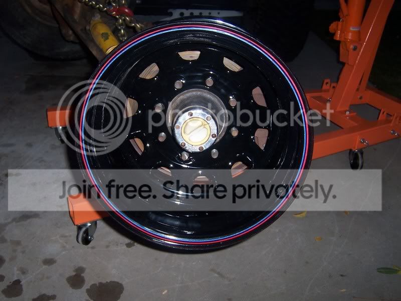

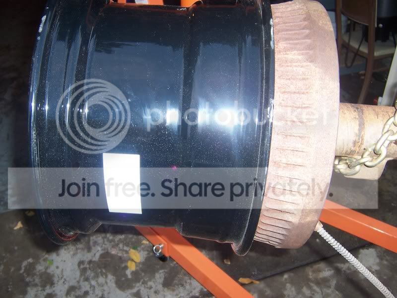

Ok, so Summit is super cool...instead of just saying oh well and back ordering the rims they sent three out of Nevada and the other out of Utah...so although I don't have them all I did get 3 of the 4 rims on Friday!

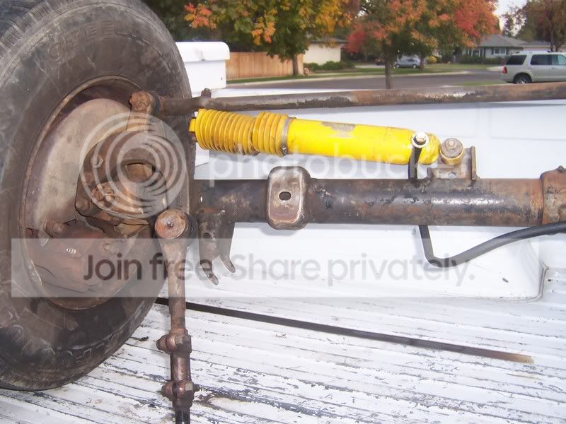

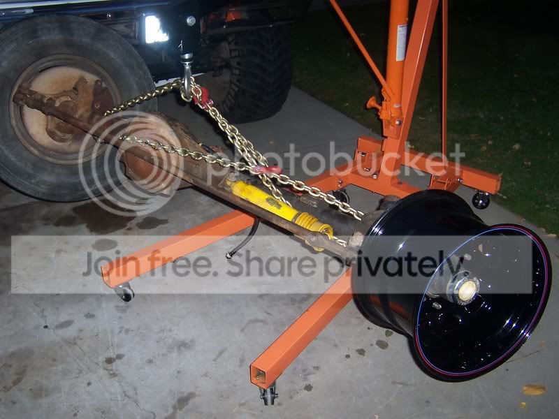

I took the axles to work with me and used the steamer/pressure washer and it got all the gunk off of them. I still need to finish grinding off some of the surface rust but 30 years of built-up grease and grime is gone.
So some time w/ the :grind: before paint and it'll be fine.
They slide right over the 14ff w/ no problems like you all said...they are close but they do fit.

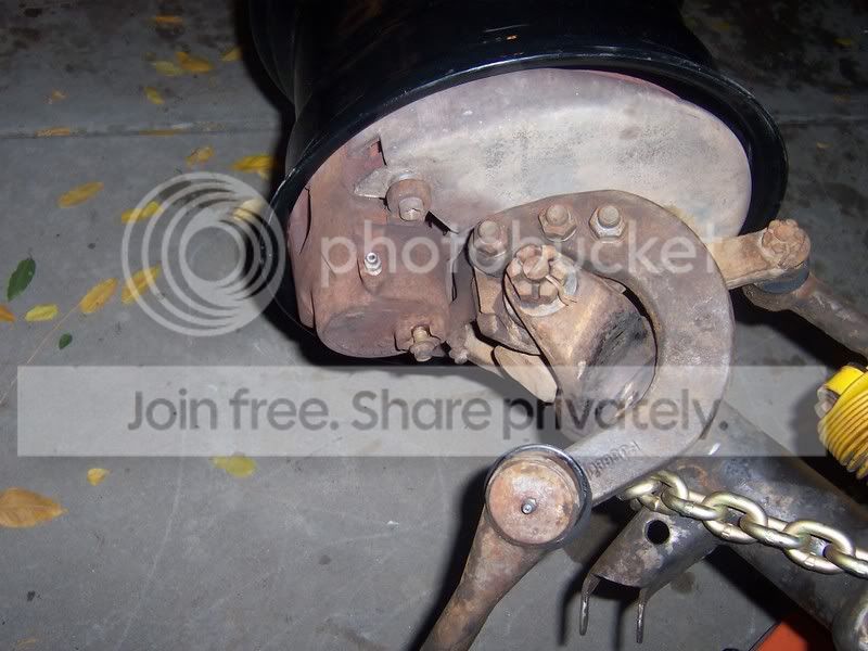

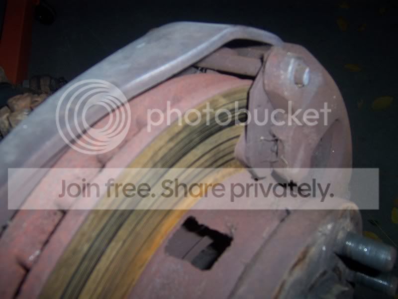

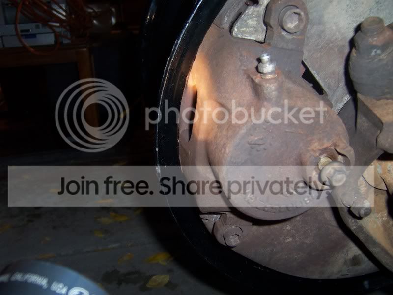

They almost make it over the caliper on the front...literally just a quick couple swipes w/ the grinder and they'll be fine.
You can see where they hit on the caliper...its the light up area then right below it....

One of the drums on the 14ff won't spin and I don't know if its because the parking brake is pulled and the spring is busted because it won't pull itself back out or what, so I have to pull that side apart and check it out. Any advise or pointers to a tutorial "taking apart a 14ff brake assembly for dummies"?
Ok, then on the front I noticed that the driver's side is hung up...its still spins but its grabbing a little...is it possible that its seized or will it let loose after I get it in and hook the lines up, bleed, etc.?

i had a drum froze on my 14bff. smash the drum with a BFH and see if it starts to spin. if it has been sitting for a while the pads might have rusted to the drum.

Oh yeah and Jim, my dad told me to do that but I didn't believe him. So just get a BFH and smash the drum on one side to try and spin it? Or just hit it in general and hope it breaks loose?

when something is rusted too, and you use a hammer its the vibration that breaks the rust not the pounding of the hammer its the vibration of the pounding of the hammer that will break it loose. i've found on big size nuts that are froze put a bfh on 1 side of the nut and use a ballpeen on the other side oppisite it and use moderate force ,but be pretty quick with the repeat strokes and make the nut and bolt set up a vibration for a min or 2 and you will find that it helps break alot of stuff aloose that and pb blaster or kroil oil(aircraft pen. oil)(if you can find it). i've found that kroil oil isn't found very much down south but up north it's in the stores, around here they never even heard of it. orange can , nope never seen it or heard of it, good stuff but blaster will climb up threads against gravity haven't figured that out yet?

psssttt his name`s Dave:D ....yea just take the BFH and whack the sides a few times, go around entire drum, then try and spin it
Youll need a special socket for the 14 wheelbearing nut, and you can get one that does both the front and the back at autozone for arround 20 bucks. While your at autozone, pick up new wheel cylinders for the 14, and new springs wouldn't hurt as well. Dont just use the bfh trick. Do it right and take the drum/hub off. Get lots of penitration lube, and spray it on the wheel cylinder to loosen up the pad/ drum.

ok, so is it a specific size (i.e. 2 1/2", etc.) or is it just "a socket for a 14ff wheel bearing nut"?
