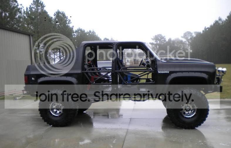

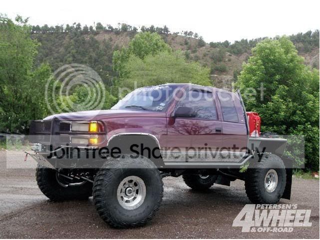

some guys have crews on sub frames, downfall is the overhang behind the tires, lots of guys trim them down.

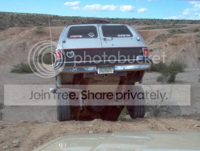

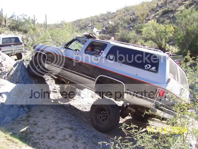

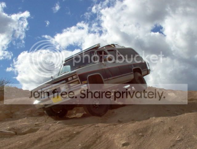

Here's last year before I removed the rear bumper but you can see how the overhang hurts. Last pic just shows that the rear isnt exactly close to the ground but anything a little steep and it drags bad
Hmmm... Thats lifted more and with bigger tires than I really want and that rear overhang is no bueno. Anyway to help that overhang without going crew cab? Maybe trim a bit and bring bumper in closer to body?
yeah it's ~6in lift and 39's. I am gonna trim a lil behind the rear tire to help. Another Burb guy on here moved his axle back to help but its a PITA from what I hear

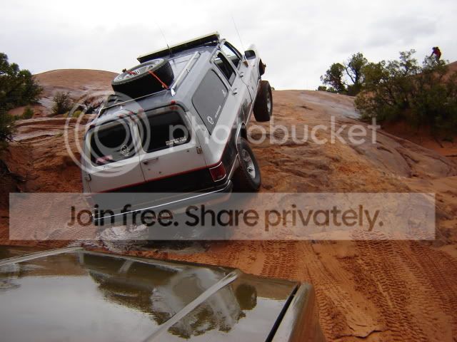

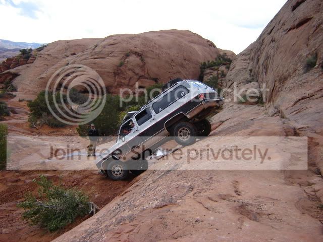

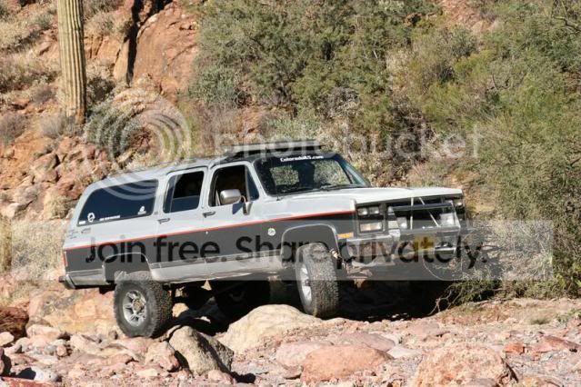

I used to wheel mine, yeah it's long and drags it's ass everywhere, high centers alot too, but as long as you know the trucks capabilities, then it's not too bad.
I basically quit wheelin mine because it was primarily rock crawling, and was tired of smashing in sheetmetal, due to it's size mainly.
It HAS worked out great for the light trail rides to get to and from the good camping & fishing spots for those weekend trips i used to make.
Mine has a 4" lift with 35" tires with sway bar disconnects. those things do wonders :)

Thats how Im envisioning mine. Maybe not so pretty. :D Oh and Ive always ditched the sway bars on my Wheelers. Also Im looking at a lot less rock. Mostly mud, trails, maybe sand n snow.

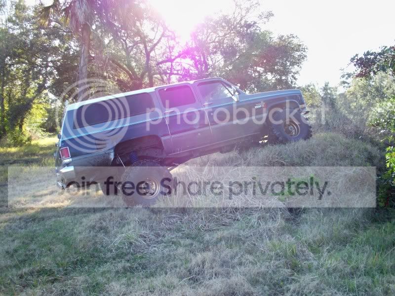

I am the one that moved the axle back for over hang, looks, and tire clearance works awesome.Yes this mod was a ton of work but so far i have only seen Mine done this way makes it unique and different most people don't even notice it till i tell them. My current wheel base is 135 1/2 it just looks really huge because there is so much body compared to the other model trucks.The back seat compared to a blazer is ten times more comfortable to get in and out and ride in. For crazy rock crawling or high speed dunes and such a blazer would be better but for all around the sub is good, and you get more looks like you are taking that in there wow.
