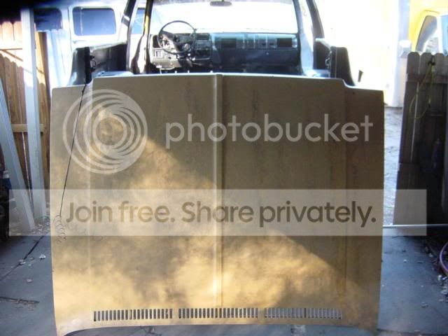

On the76 blazer the hood originally tapers back towards the cab above the head lights on both sides2-3 inches.I narrowed the hood right where the taper began.With the taper cut out the hood doesen't line up as well with the fenders.No much I could do about it.The 80's K5 hoods are straight and would line up better with a front taper job.OnceI get it on the trails and get a few dents in it I'm sure it will blend in better :D :D
Here is a pic showing where I cut the hood
