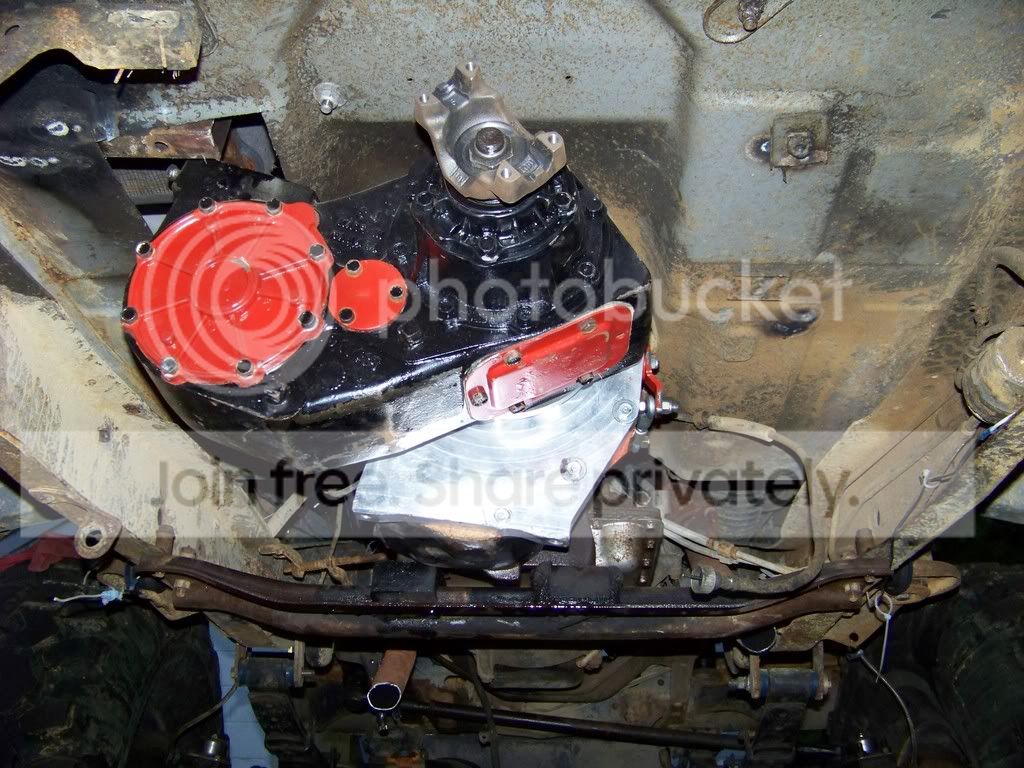

here is my old one.i had a clocked 203 so i couldnt use the foot on the adapter.i used the spacer for mine and it worked fine.only diffrence is this is a ford 205.

this is my old rig but i was running a stock front end and a set of 64s in the rear.i was running a square tube in the front and the rear was a stock rockwell 2.5 ton driveshaft.both shafts were almost equall in length
