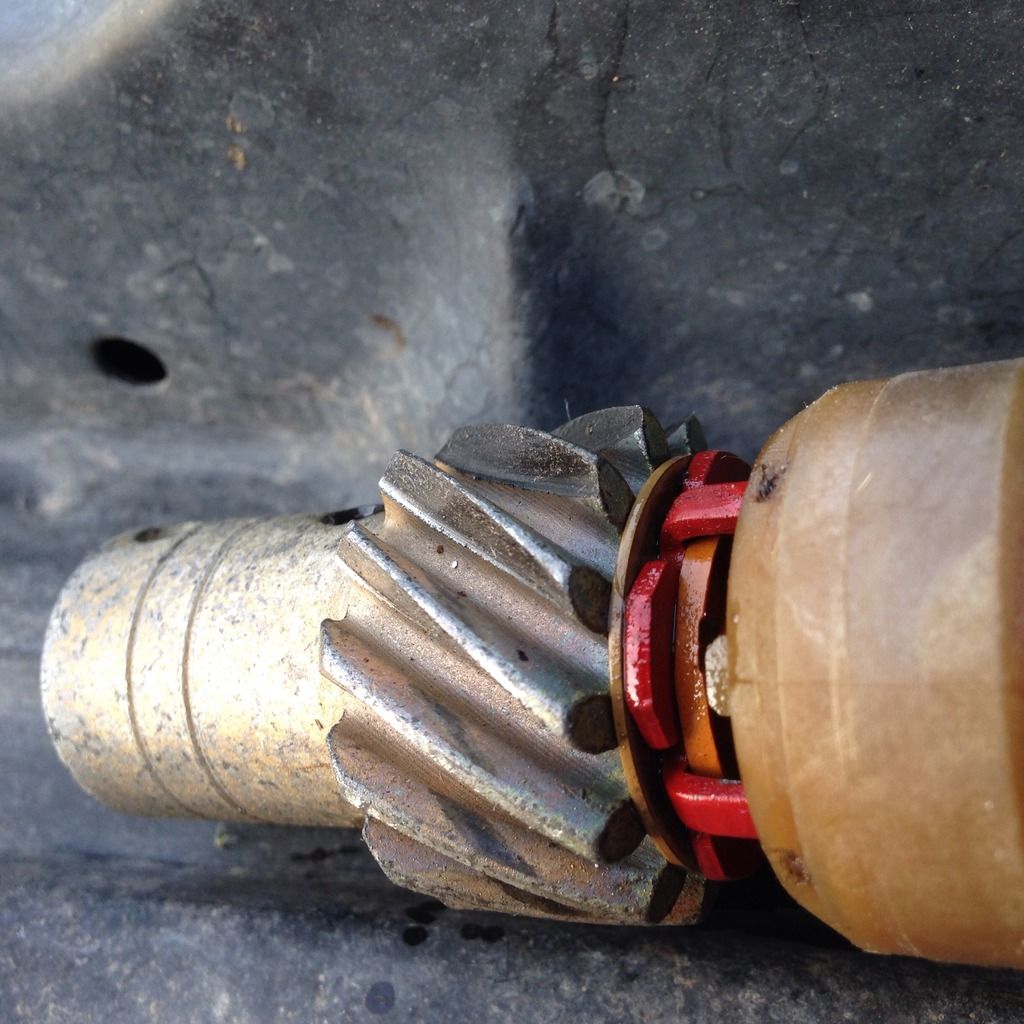

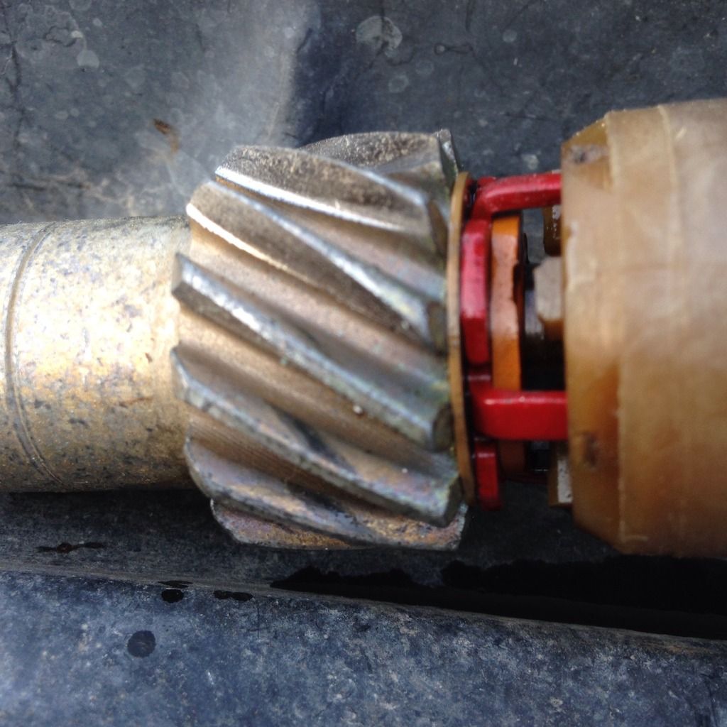

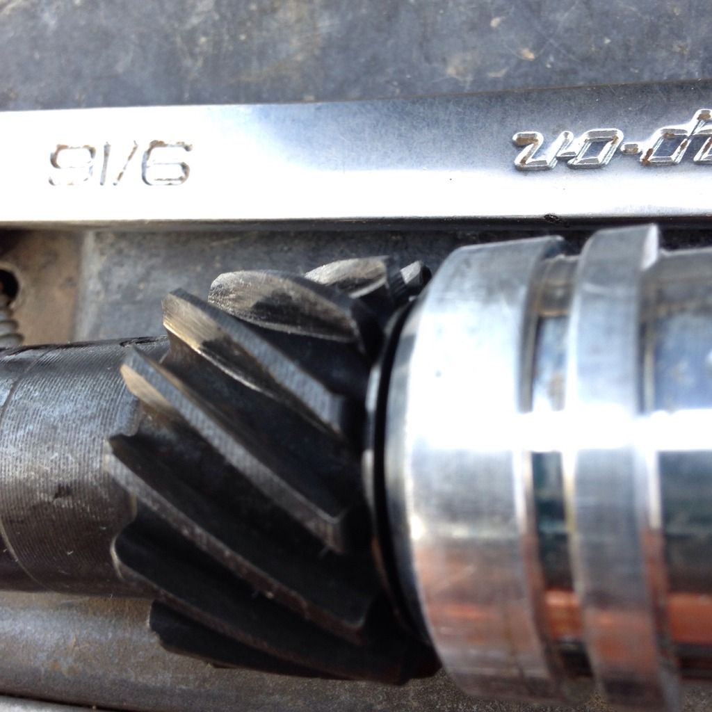

I had an LT4 Hot Cam in my 1988 V10 Suburban. I figured a stock LT1 (from a 1995 Z28 I believe) would be a better camshaft. So I swapped in the smaller cam. It chewed up the distributor gear on the stock distributor from the 1988 LO5 350 TBI. It was originally a flat tappet cam distributor. I then tried a distributor from a 1992 Camaro LO3 305 TBI that had a factory roller cam.
It chewed up that distributor gear.

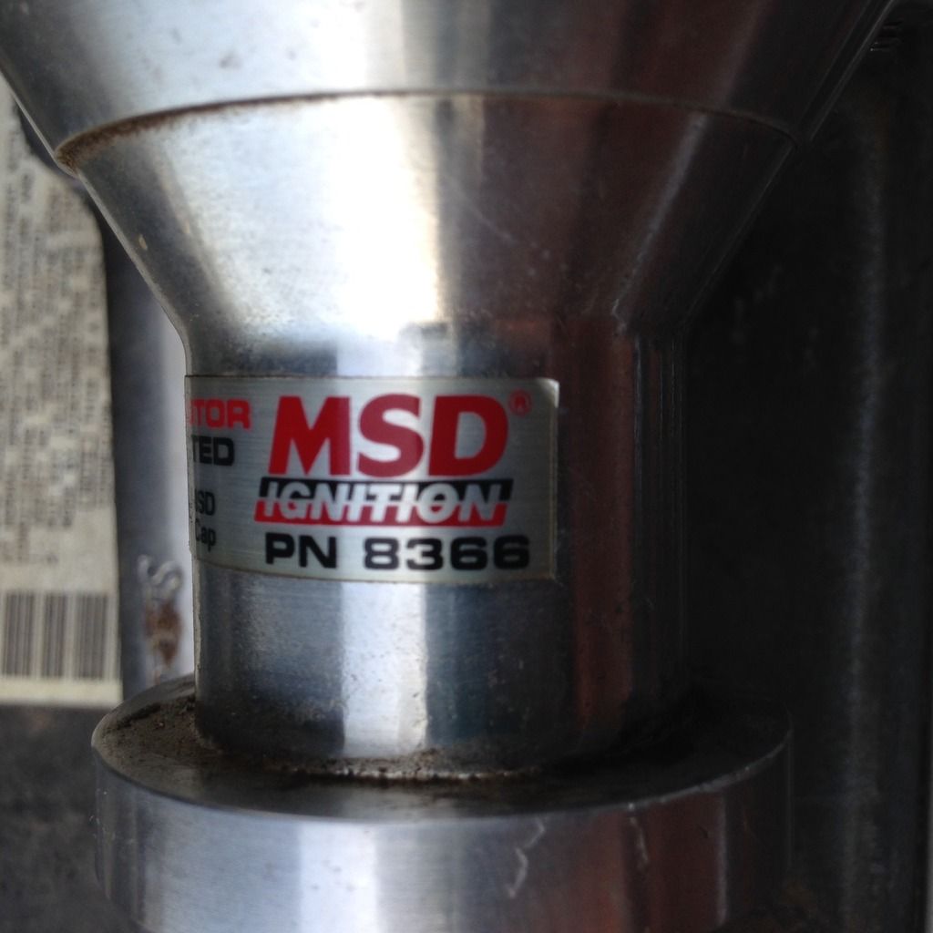

I then tried an MSD distributor. Seen here.
j
It has begun to chew it up already.
What is my problem?

roller cams REQUIRE the use of a hardened distributer gear. :waytogo:
simple fix.
The term I've head before is a "mellonized" distributor gear...?
I believe it's a harder material that's used for certain applications, and I'm pretty sure MSD can supply them as a separate part if you need one for your application.
Pretty sure my 502BBC requires one, but I don't know all the other applications out there where it is required.
-G

That is what I thought, but I talked to someone at MSD, and they told me what I had was right. He also might not have known what he was talking about.

If you brought me those dizzys, and asked me what was wrong, without knowing any of the detail about what they were, I would have three ideas.
1: The wear pattern looks like the gears might not be meshing fully.
2: I would check lubrication.
3: And probably most important, if you keep replacing half of a gear set, because that half keeps wearing out, then the problem is most likely with the half you did not replace.
Are the gears an odd number of teeth? If so, then then any one tooth will eventually touch all the other teeth.
So, one small burr would eat up all the other teeth.
Google "LT1 distributor gear wear" and you'll find Martin has lots of company ..
I guess "something" causes the gears to get wiped out,but none of the threads I read on the subject seem to have pinned down a cause...some blame a high volume or pressure oil pump,the oil pump drive shaft or coupling,or claim a specially treated "melonized" gear or one made of hardened billet ,bronze,or unobtanium is needed..others say an aftermarket intake may allow the distributor to drop down too far and it will need shimming to get correct gear alignment..
