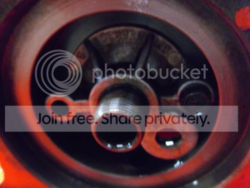

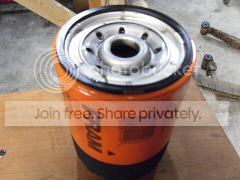

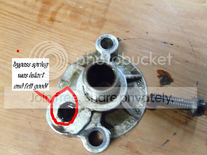

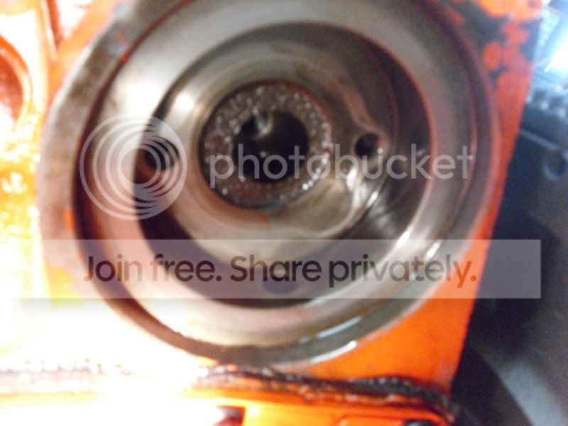

Here are the parts as I have removed them:
New FRAM, there is only 1 seal
Clean Filter Seat
Oil bypass and thread

In the 2nd pic, did you already remove one of the filter adaptor bolts? There is supposed to be two.
Hmmmmm there was only 1 bolt when I removed it, nice to point that out. Funny you mention it because there were 2 threaded holes and I wondered what the other one was for.
Do you think that could be the problem though?
I would think with only one bolt there tightening the filter would pull one side down and away from the block, and not give you a good seal at the filter. It very well could be the problem...

In pic # 2 there is an o-ring gasket stuck to block. But in later pic its gone. Did you take it off ? Or is it just a shadow ?

The oil filter adapter contains a fiber-disk and spring bypass valve. Make sure everything is clean and that the valve is positioned correctly in the housing (arrow).
on top of 1 bolt only for a 2 bolt hold down . i would also install a new adaptor/bypass as this one has been stressed and streched .
might not seal or be cracked even by now.
but yes 2 bolts hold that on.
:haha::haha::haha:The Fram was only for a test to rule the previous filter o ring out as the culprit. So yeah with all being said I am not sure we have found the exact root of the issue here. Yeah, i looked into all the passageways, the all seem clear. I tossed the original filter, and the Fram seemed good inside. It seems right though that as the filter made contact with the block that it would probably seat itself flush upon being threaded on correctly.
