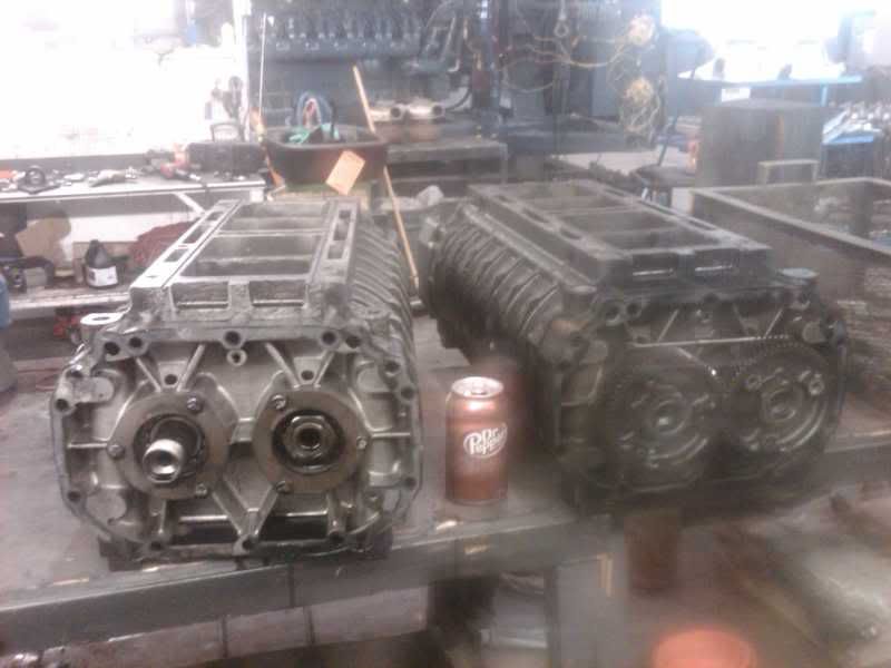

heres the pair of blowers out of a 16v149, they weight about 150lbs each as well.
those blowers in in the bottom of the V under a valley plate under the aftercoolers.
