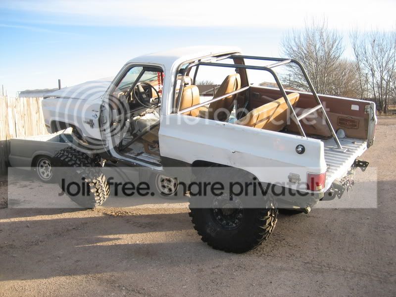

Find a 14ff from a van thats what Im runnin.
Sorry its an older pic but you get the idea.
