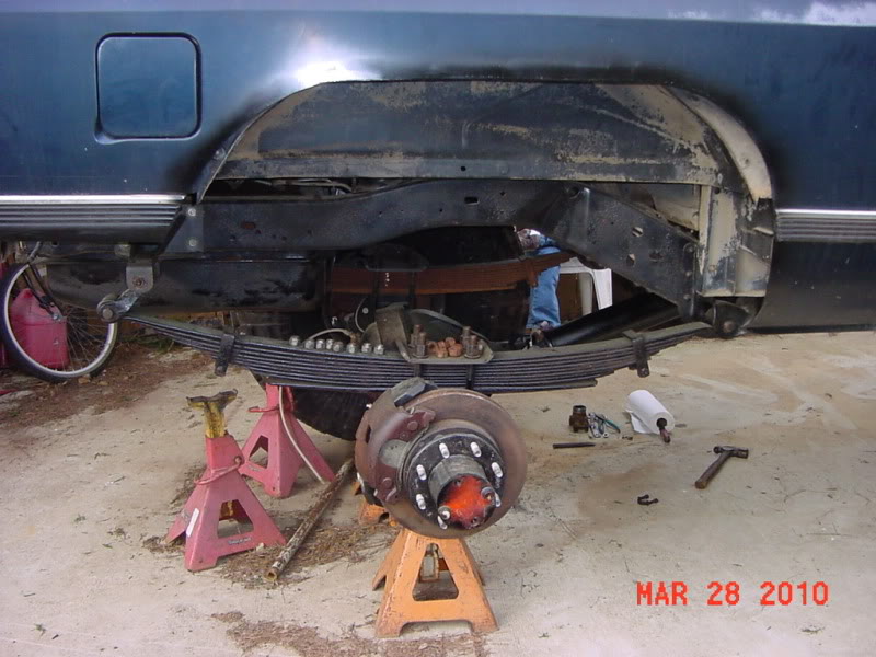

burb and 7 leaf 56" rears i think you will be happy . if to firm pull a lower leaf each side .
i did a set of 22-547 springs in a blazer with a ord 4" flip and super shackles . we had to pull 2 leafs per side to make him happy with the ride . it was firmer than stock blazer rear springs but not bad at all .

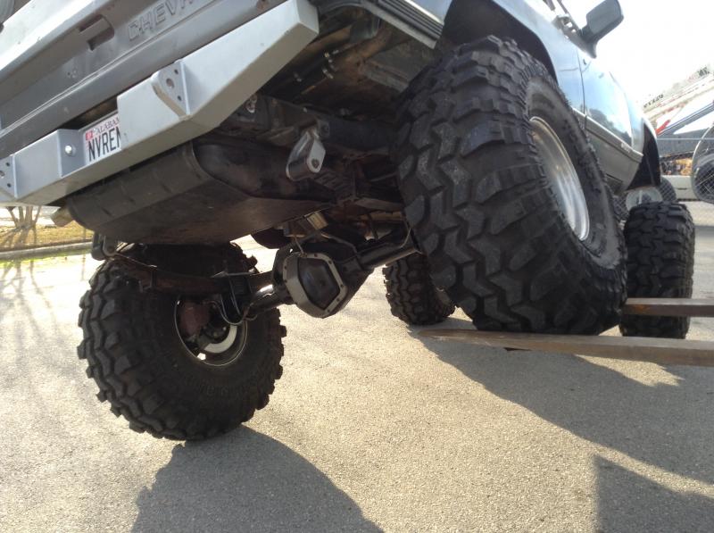

here she is FLEXING out
the front is 4" tuff country HD and zero rate 1.5" forward . the rear is 22-547 springs and ord 4" flip and super shackles and axle back 1" with aftermarket perches on the axle . if i recall it was #5 & #7 leaf we pulled each side .she is riding on 37x12.50x17 tire and wheel combo and a 1.5" aluminum body lift .
22-547 spring info https://www.sdtrucksprings.com/index.php?main_page=product_info&products_id=7356
i also have the 22-547 in my k30 rear with a flip and super shackles . all the leafs are still in them pack . i added timbren bump stops for extra weight capacity as i need it . every one says how does my k30 ride so nice compared to other k30s so stiff in the rear .
